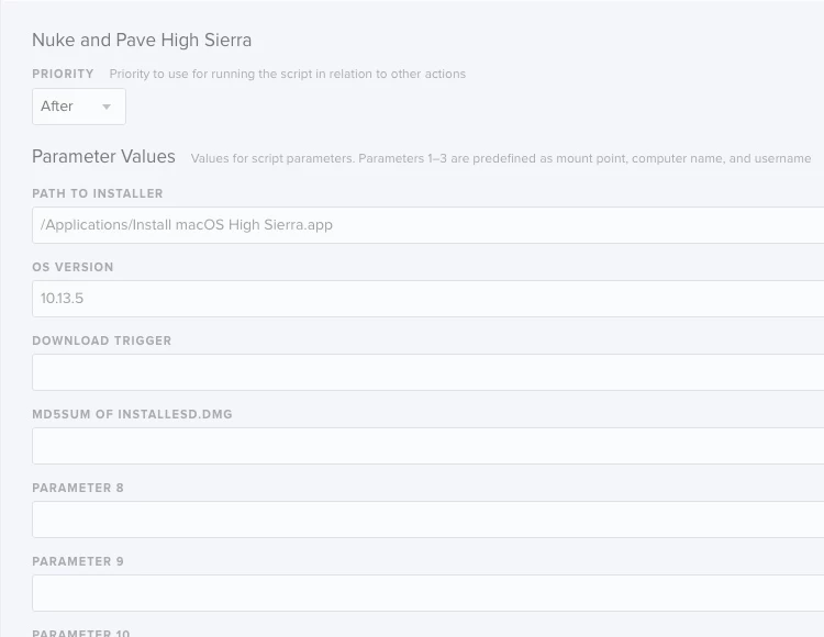

Trying to go from 10.12.6 to 10.13.5 with a pre-downloaded High Sierra installer (run from a separate policy) and using the v2.6.1 of the @Rosko script. I am shooting for a non interactive method via policy to kick off the upgrade if possible.
I have the script configured to use the eraseinstall command, however when the upgrade policy runs it shows the "Please wait as we prepare your computer..." window then just never completes and throws me back to my existing Sierra desktop. I have read there are issues when trying to convert HFS (which is what my drives are) to APFS along with the macOS upgrade. Is this the reason it dumps out or am I missing something else? Attached is my Upgrade to High Sierra policy script config.

@kricotta - The --eraseInstall switch is only available on APFS volumes, hence the machine needs to already be on macOS High Sierra and have been converted to APFS.

@Rosko thanks, I turned off the option but still seem to be having issues. Basically when applied, it upgrades to High Sierra but doesn't do the APFS conversion at all. Is it possible to upgrade the file system to APFS in a different step or policy in Jamf and then following along behind that with the upgrade to High Sierra?

@kricotta if you are using the workflow here unmodified, then it should do the APFS conversion. If the upgrade is going through, but not the conversion and the script is the one mentioned, I would assume something is failing along the way and you'll want to dig into the /var/log/install.log and /var/log/system.log to see if there are any errors there pointing out to what happened.
