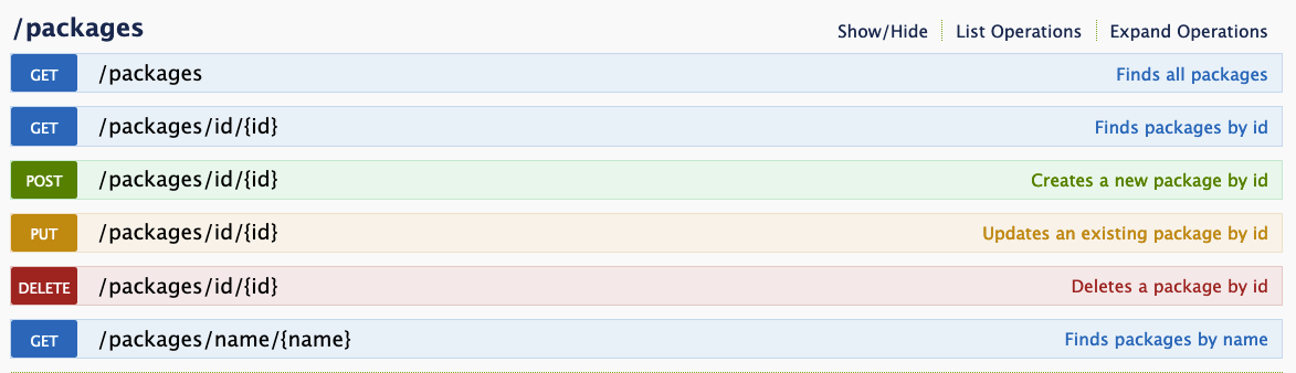

i think i might be wrong but i believe it is possible with the API - after a quick look - I have personally never done this but if you navigate to <yourjssurl:8443>/api/#!/packages
threw this together in about 3 minutes - NO IDEA IF IT WORKS BUT THIS IS THE JIIST - will test & update during freetime throughout the day. In theory - the api will get the package, download it to a location on your computer & the the installer flag will install it.
somebody correct this I'm not an API guru but I know im close lol

I don't believe you can pull down the actual packages with the API. The /JSSResource/packages/ resource is for pulling down the XML details on the package, such as the ID, display name, file name, priority, OS requirements, whether FEU or FUT were enabled and so on. I don't see anything in the output that let's you pull down the package itself, because the package is not stored directly in the database. It's on a distribution point, whether a cloud one or local.
There are hash_type and hash_value keys in the xml, but I don't think it's possible to use those. I've never tried using that though.
i do believe you are correct & this is in fact the case @mm2270 after reading a bit more into it - i don't believe its possible - hence the "I think I might be wrong" intro lol
