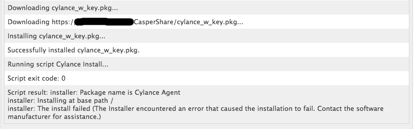

I followed the steps and it did install with the token. I did get this error in the logs though, but the install was succesful.
Executing Policy Cylance Unattended with Token
Mounting dmartin_share to /Volumes/CasperShare...
Verifying package integrity...
Copying Cylance.pkg...
Installing Cylance.pkg...
Successfully installed Cylance.pkg.
Running command /private/tmp/Cylance/install_cylance_with_token.sh...
Result of command:
installer: Package name is Cylance Agent
installer: Installing at base path /
installer: The install failed (The Installer encountered an error that caused the installation to fail. Contact the software manufacturer for assistance.)
  • July 11, 2016
I uninstalled Cylance, flushed the logs and tried again and this time completed successfully without error.
Thanks @Chris_Hafner and @wayfaircasper for your help.
Jonathan

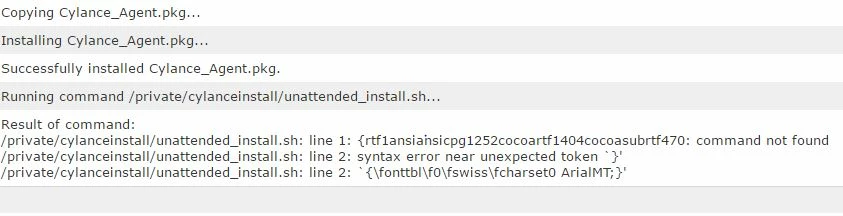

I'm continuously getting this error when testing.

@Chris_Hafner
I got it to install but I still get errors from the logs:
Result of command:
Also, periodically the agent would run in Offline Mode. Is this to be expected?
Chris_Hafner
Forum|alt.badge.img+27
  • July 13, 2016
@jonathanla Was having the same issue. Perhaps, due to a previous installation of Cylance while he was testing this out. He uninstalled Cylance fully, and then re-installed via this method and stopped getting that error. Is your circumstance similar?
franton
  • July 13, 2016
@sedwards00 Your unattended_install.sh has been saved as a real text format. Make sure it's actual txt and that error you posted will go away.

  • July 13, 2016
@Chris_Hafner I was able to get that error to go away but it has reappeared on every completed log.
  • July 13, 2016
@franton At first I made that mistake but since then I been saving it as plain text in TextEditor.

  • October 12, 2016
@Chris_Hafner
Thanks for that. I was drawing a blank on the InstallationDeployer name. We run enterprise, so had to do a bit of a rework but made it much easier.
I did mean to ask if anyone solved the issue of receiving the error regarding the installer saying it failed. Yet a few lines prior it says it installed. I've tested on numerous computers (all OSx Sierra) and can confirm Cylance is working.
A complete uninstall and reinstall puts out the same message in the logs.
Chris_Hafner
  • October 13, 2016
Interesting. I don't see those failures in my installs. That said, I am running the Cylance installer as a .pkg with the installer script running as part of the postflight. That might mask any errors...
  • October 13, 2016
@jonathanla
In one of your posts/comments you mentioned that you "cleared the logs" which specific logs did you clear to remove the error?
@Chris_Hafner
I noticed that if I drop the pkg onto a machine via Casper Remote no issue, if I then try to initiate the script via Casper Remote is when I get the error (again it does install Cylance).
Removed Cylance from the test machine, dropped the pkg back onto the test machine and this time on the test machine as Root, manually typed in the script via Terminal. No errors. Everything installed and is happy.
Removed Cylance again....dropped the pkg back onto the test machine (again) but this time on my main Mac ssh into the test machine via Terminal and manually typed in the script. The error popped up (Cylance does install). Ok, so it's not playing nice when having to ssh. All other packages/scripts we have been using are working.
