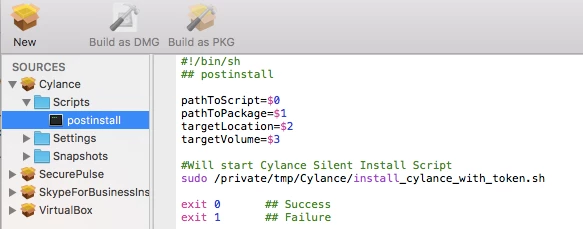

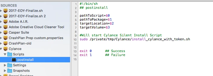

@Chris_Hafner I would just like to chime in that I have tried following the steps on this post (specifically what you have done) and have not been able to get it to install.
Here is what I have done:
Created the Cylance folder in private/temp
copied it to composer
added the postinstall script
created a pkg
I tried running the .pkg on my machine and it "appears" to install because it says it completed successfully, but nothing happens. It is actually not installed.
I then took that same .pkg and put it into Casper and same thing (i had some hope that maybe the execute part would work)
All i did was add my token to the file and made sure the patch was correct.
I am not sure why it fails. When i look in the tmp folder i see that it created the folder Cylance along with the .sh and the cylancePROTECT.pkg, but it does not seem to do anything.
Is there a good way to troubleshoot this?
If i run the CylancePROTECT.pkg file it will ask me for the token, and everything works fine (obviously).

Picking through what you've typed the first question I have is, are you putting the script that contains your token in the folder with Cylance (in /tmp). The script should contain at least the following with your token in the place indicated.
echo PLACE_TOKEN_HERE > /private/tmp/Cylance/cyagent_install_token
sudo installer -pkg /private/tmp/Cylance/CylancePROTECT.pkg -target /
If you've done this and it's still not working check permissions in Composer.

In Composer I have the following permissions set:
Private folder - owner root (0) (R,W,X) Group - Wheel (0) (R,X) Everyone - R,X (mode 755)
tmp folder - owner root(0) (R,W,X) Group - Wheel (0) (R,W,X) Everyone - R,X (Mode: 775)
Cylance folder - owner root (0) (R,W,X) Group - Wheel (0) (R,X) Everyone - R,X (mode 755)
CylancePROTECT.pkg - owner root (0) (R,W,X) Group - Wheel (0) (R) Everyone - R (mode 744)
install_cylance_with_token.sh - owner root (0) (R,W) Group - Wheel (0) (R) Everyone - R (mode 644)
I should note that I have not really used Composer before... but maybe it is the permissions on the .sh that could be the issue?

The cygnet_install_token is only for the chance install, as your script has this: echo PLACE_TOKEN_HERE > /private/tmp/Cylance/cyagent_install_token
I assume that is when it gets generated, but it is not used for anything else that i know of.
My postinstall does not have my token in it only the script that i have called install_cylance_with_token.sh
echo my token here > /private/tmp/Cylance/cyagent_install_token
All of the permissions set on the files in Composer are described in an above post:

Wow, I'm not sure why I didn't notice this before but your "isntall_cylance_with_token.sh" script doesn't seem to have execute permission. When dealing with the /private/tmp directory I find it easier to give everything in that folder the same permissions as the /tmp directory itself. Using composer this is VERY easy to do. In your composer window, Highlight your "Cylance" source, then select the /tmp/ directory. Then select the "gear" icon next to the permissions check boxes in the lower right-hand side of the window. Try selecting "Apply Permissions to Applications and All Enclosed Items.
Compile that as a .pkg and give it a shot!

Thanks for the information. So i made the change for permissions as you suggested.
The package for some reason woould not work. So i deleted everything i had created and started over again. And now it is working properly.
Thank you very much for all your help on this. Much appreciated!
