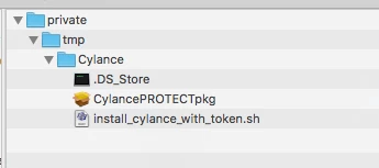

OK, just to cover all of our bases. Please double check the following. There should be a Directory in /private/tmp called Cylance. This will look like this in Composer (feel free to remove the .DS_Store)
I've screwed this up in the past by changing the name of something... like the installer package itself.

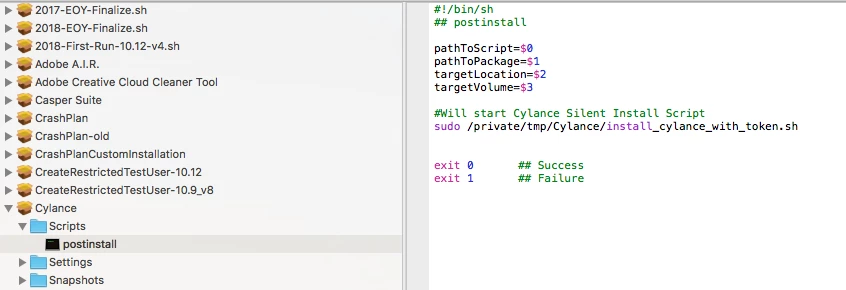

The PostInstall script will look just like this:
What appears to be different with what you have?
  • October 13, 2017
The post install script was not present, I added it and then from a Terminal ran "sudo sh /Private/temp/Cylance/install_cylance_with_token.sh and it ran without issue. I re-saved the /Private/temp/Cylance/install_cylance_with_token.sh on the device and I just tested it via JAMF.
Thank you for your help, I really appreciate it!!
