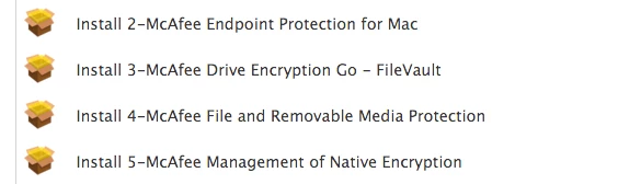

  • March 1, 2017
We have seen this issues and its the order your install the packages. we have it setup like this to install:
Agent First, then:
There is an order to install or it will fail.
