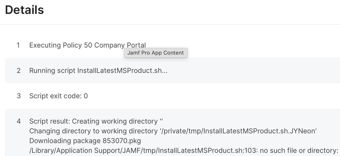

Hey guys. We have a few policies run with trigger of “enrollment complete” for new prestage loads. We’ve typically had these install packages, mostly for Microsoft stuff. We’d like to make sure the machines get the latest version at load, and don’t necessarily want to update the package every time. We thought we could use the InstallLatestMSProduct.sh script within one of these policies to test, and it turns out, the package being called via linkID won’t download, and the policy fails. We have the same policy set for self service and that downloads the package just fine, so we think there’s something with the enrollment process that isn’t allowing the policy with a script to download the package properly. Has anyone seen this? Is it not advised to run a script as part of a policy with “enrollment complete” as trigger? Thanks in advance.

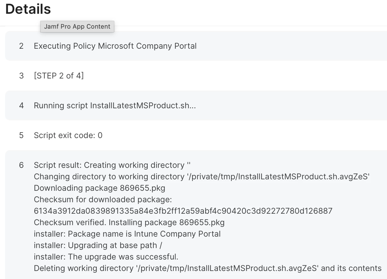

I get what you mean, but the script doesn’t fail to run, it just doesn’t complete the download. See below for failed policy run at enrollment vs similar policy (successfully) run via self service.

Chubs
  • Jan 5, 2026 11:12 PM UTC
It’s your installer directory.  Change it to something that actually exists like /tmp/ or something.

/private/tmp/ does exist, as you can see in the successful policy which uses same directory.

Yes but look at your failed installer - it’s looking for this: “/Library/Application Support/JAMF/tmp” which does exist, but requires explicit permissions.  We’d have to know what the script is doing to see why it’s failing and where.
I see, but the script has no mention of /Library/Application Support/JAMF/tmp, so not sure why that is listed in log. For clarity, this script is on git here.
