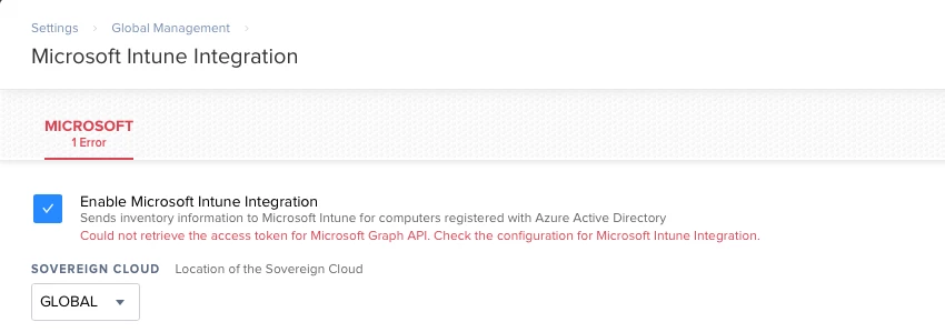

I'm trying to setup Intune, but getting errors before I can even get the connection. I enter the info, but get the error "Could not retrieve the access token for Microsoft Graph API. Check the configuration for Microsoft Intune Integration."
What do use use for the Azure AD tenet name? The ".onmicrosoft.com" subdomain?

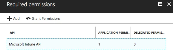

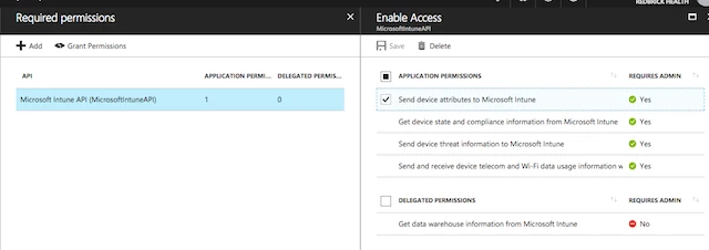

This is the only permissions I set for the app:
  • December 20, 2017
Also make sure to hit the "Grant Permissions" after deleting the only permissions and adding the new one.
