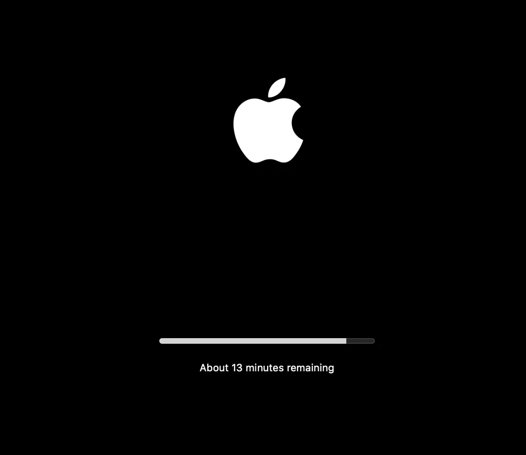

  • February 14, 2019
Old thread I know.. But stumbled across it as I'm having the same issue with recon taking forever/not finishing at all.
What I've found is that it's failing on computers that I've performed an eraseinstall on (10.14.2) & haven't yet logged in since the re-install.
The first login looks like this:
After this first login, recon works fine! My assumption is that something is busy/locked until this post install process takes place.
Any other theories or additional info about this update process would be appreciated.
