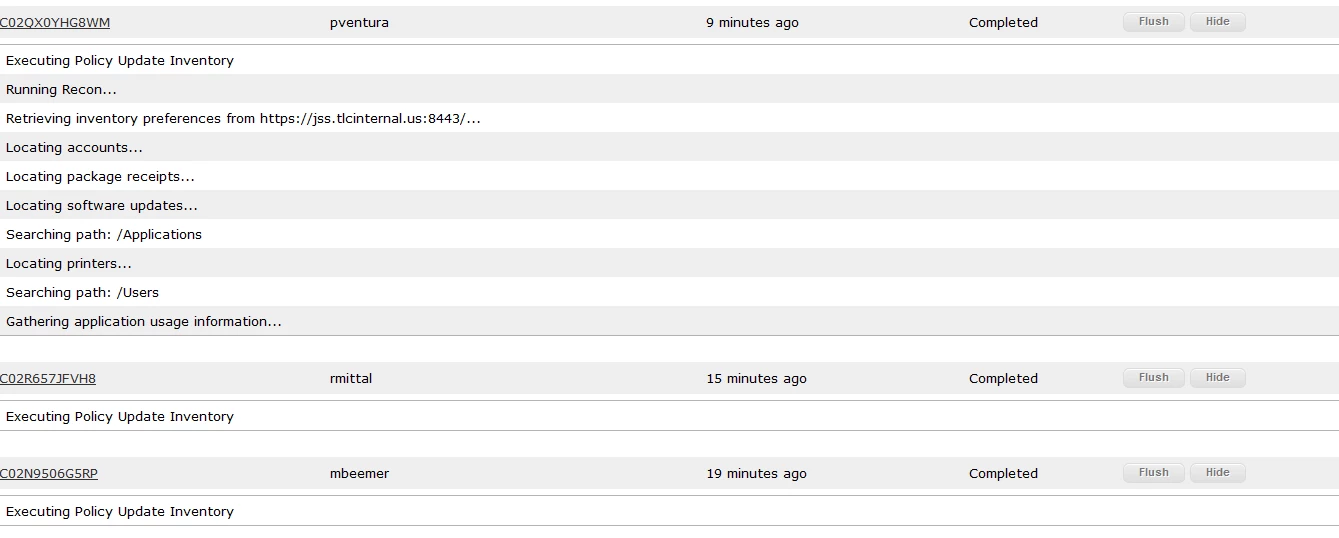

Looking at the policy logs, the bottom two in the screenshot are the ones not executing. The top one is successful. Looks like the "update inventory" option is broken. Perhaps I can replace this option with a single line shell script that just does "jamf recon" Thoughts?
