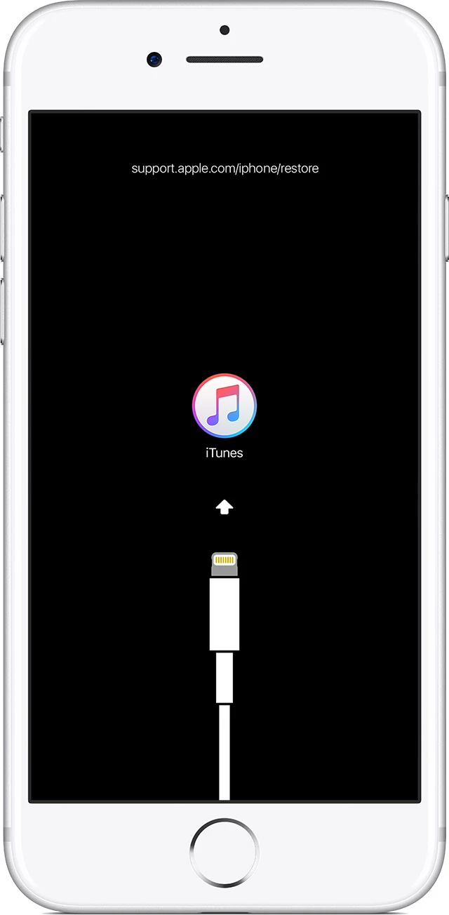

Forum|alt.badge.img+21
  • February 20, 2018
You should not see that error if the device is in Recovery Mode. You should only see that error if the device is booted when connected to Configurator.
When you connect the iPad to Configurator, do you see this image:
(note image is from Apple KB and shows iPhone, not iPad, but on-screen image is similar)
If not, then the device is NOT in Recovery Mode. Disconnect and try again.
