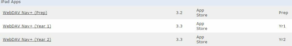

Hi All,
Does anyone have this issue?? iOS Apps scope in JSS send to incorrect group. Even thought you try remove the apps it will still install it back? See my Webdav apps which I only set to yr2 group but it install on yr1. I am using JSS v9.81. Currently all ipads is using iOS 8.1 - 8.3.

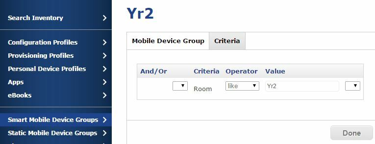

@dan86
The first thing that stands out is the smart group criteria.
You’ve got “like Yr2” in there, but if Year 1 is abbreviated as Yr1 for the room name, the group is going to pick that up as well because your criteria is set to “like” instead of “is” since Yr1 is like Yr2.
If you change the group criteria to Room Is Yr2 does it behave as expected?
Thanks!
Amanda Wulff
JAMF Software Support
bpavlov
  • October 13, 2015
@amanda.wulff How is Yr2 like Yr1? I could understand if it were like "Yr". But shouldn't like "Yr1" mean it needs to find the 3 characters in consecutive order "yr1" within the particular field that's being search?
So for example like "yr1" should pick up: RandomYr1Text (since it has all 3 characters consecutively within the result)
But should not pick up: RandomYrText (since it's missing the number 1)
  • October 13, 2015
@bpavlov
One would think; the like operator does act as a wildcard, and should be looking at all three characters.
If we change it to is from like and find that it behaves as expected with that change, I'd recommend getting in touch with your Technical Account Manager to get case opened up as, if we can reproduce the behavior in house and it turns out it is not expected behavior, we'll want to get a defect filed.

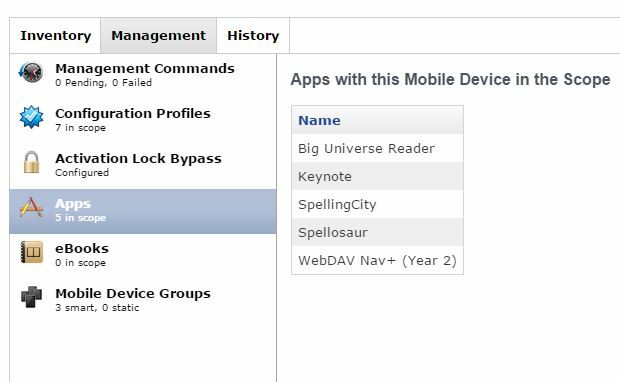

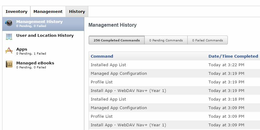

In your first screenshot, I can't tell it Prep, Yr1, and Yr2 are the Scope or a Site. I assume Scope.
Are both screenshots of the iPad, the same iPad? Then it is showing as being in scope for the Year 1 App, but the Year 2 app is being automatically installed?
If so, I don't think any of us are going to be able to help - you'll need to have support webex in.
  • February 4, 2016
Screenshots of same ipad. The scope shown year 1 Apps but been pushed with Year 2 app. I wonder is it JSS unable to handle mutiple webdav app? The rest of the apps is working fine since it just single app assign to all. The support groups also unable to verify this issue, can only suggest me to manually remove and install again.

Nick_Gooch
  • February 5, 2016
@dan86 What version is your JSS at now? 9.82 has a fix for a defect that sounds similar to what you are seeing.
[D-009880] Fixed an issue that prevented the scope of an app from being respected if there are
multiple apps with the same bundle identifier in the scope of multiple sites and one instance of the
app is updated
