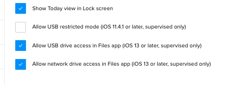

The USB change happened earlier this year. (see attached) USB restricted mode is what you're looking for. Make sure this restriction isn't enabled in your Restrictions configuration profile.

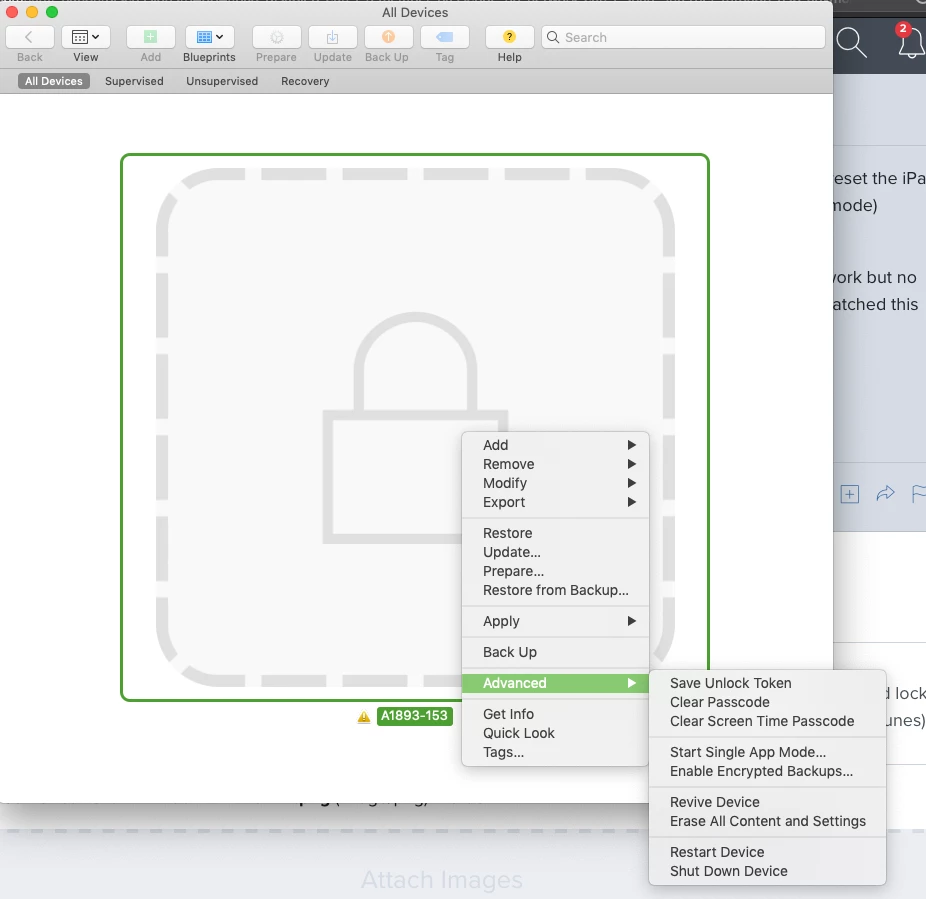

As to the devices that are off network and locked, DFU restore is probably your only option (depending on the model, hold power and home until it tells you to connect to iTunes), use Apple Configurator 2 and do a Advanced -> revive device (see attached)
