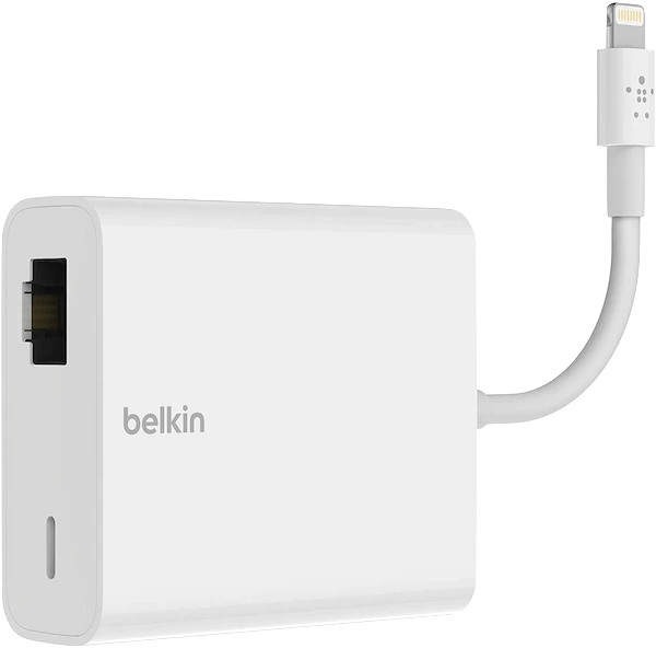

For anyone on premises, you can look into providing your techs with adapters they can connect to locked devices to wired Ethernet. This connection bypasses wi-fi and allows your device to receive management commands. There a multiple solutions you can find. I like this one because it's all in one piece.
Consider putting one of these devices in each library and leave it permanently connected. If students need their passcodes removed, your Help Desk can send the management command and then the student can plug in the device without involving a technician.
Talking moose is correct however you need to make sure you have the USB Restriction disabled and pushed out to your supervised devices or it will not work.
