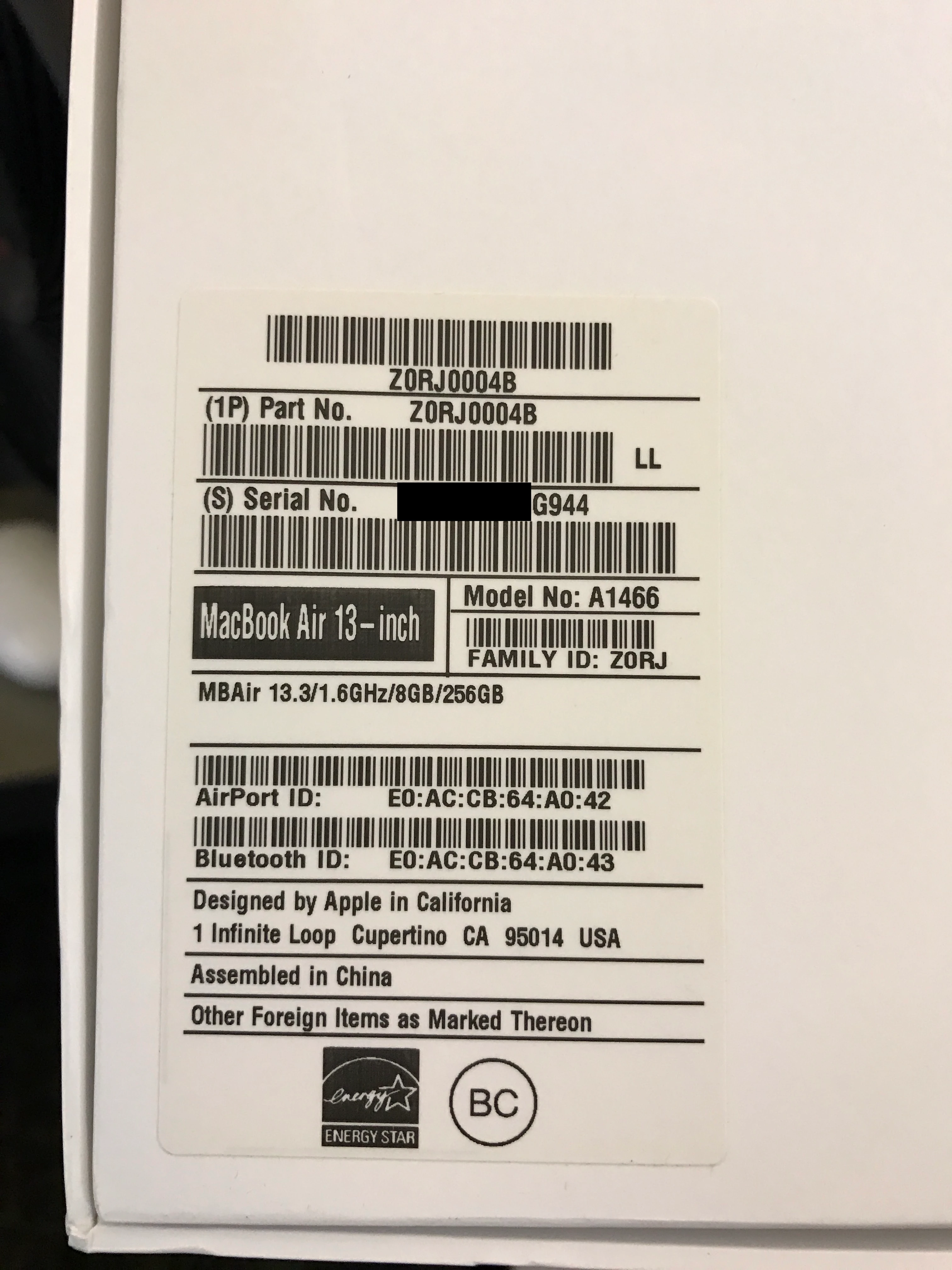

If you have a box lying around, apple does put the model on them. Every apple box should have it, actually (iPhone, iPad, anything with an apple logo on it should have one). Standard order items usually end (or at least used to) in the ll/a designation.
