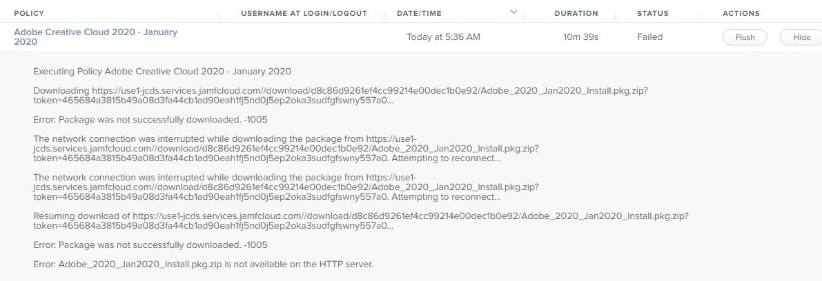

Higher education site. As such we have computers labs of 35 systems.

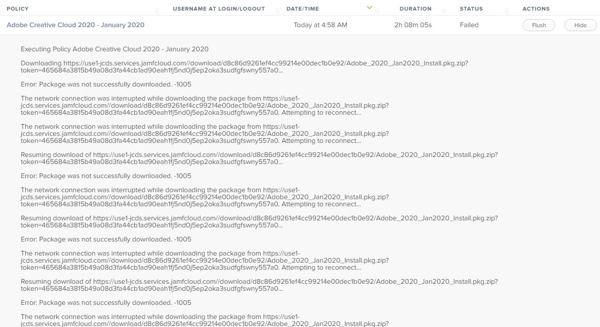

When setting a policy to install a larger application (ie Adobe CC 2020 / Microsoft Office) we using a recurring check-in policy. The policy will start to download at various times as expected but on some systems will never install successfully and then report as failed in the policy log. Sometimes it fails after 10 minutes sometimes after several hours (2+). The policy will work on some systems but will fail on others. Its not the same systems failing each time.
The log states the the network connection was lost but these are desktop computers with wired network connections.
Side note: Why if a policy fails will Jamf not try to install the policy again? Is this a setting i am missing? As of now i have to check the policy log and flush out the failed policy?
