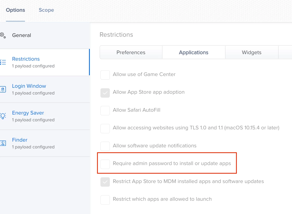

Having really weird behaviour with trying to install VPP apps either via Auto Install or Self Service, whereby in random circumstances the following log appears in /var/log/install.log when trying to install an app and it fails to install. More to this once one fails they all fail, when one works they all work. This can even be seen on the same device after a device wipe with nothing else changing. Have tried the common options in the restrictions profiles which i have found in other older posts but still cant seem to sort out what is occurring that is different across enrolements.
2022-03-22 22:28:36+10 XXX-root installd[538]: PackageKit: Install rejected with error: Error Domain=PKInstallErrorDomain Code=100 "Authorisation is required to install the packages." UserInfo={NSLocalizedDescription=Authorisation is required to install the packages.}
Anyone run into this before?
Running different versions of 12.2 and 12.3
