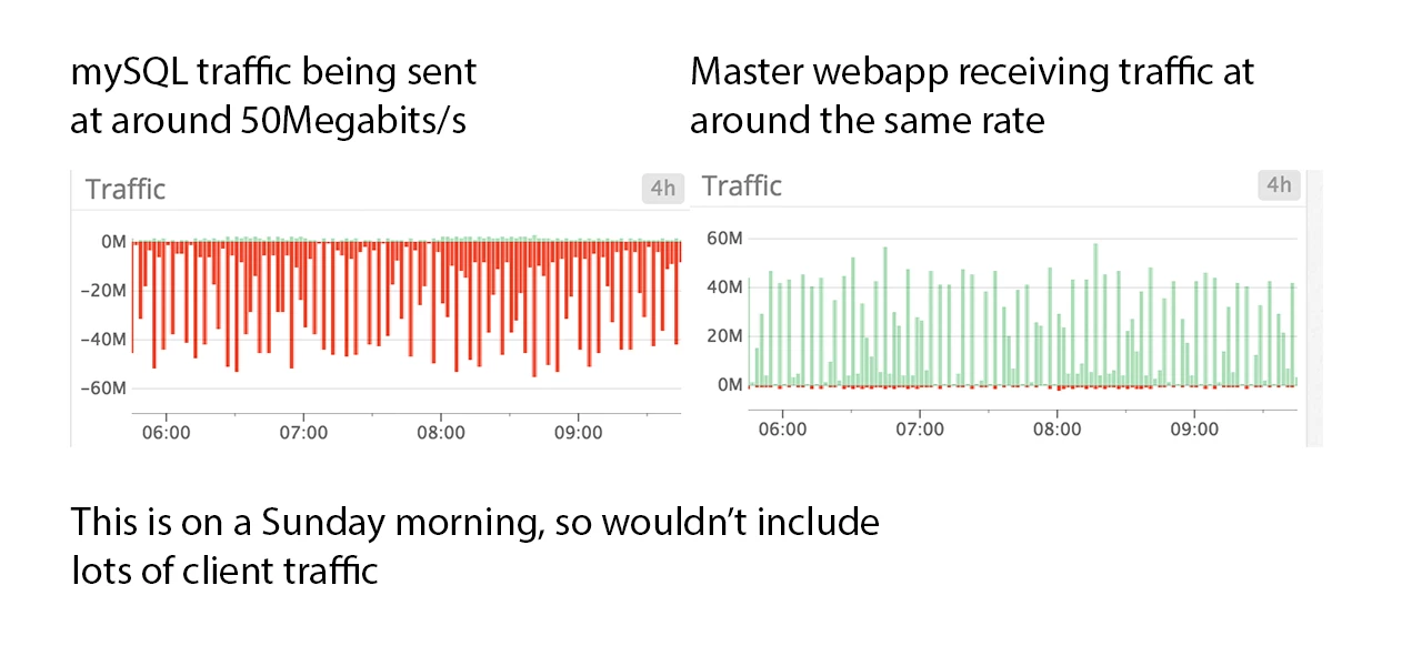

I currently have a case open with Jamf on this, but haven't found a solution. In my case, my master JSS is almost constantly receiving massive amounts of data from the database server. Do you have your database server separated? Is there an extremely high amount of traffic going between db and master JSS?
russeller
  • October 1, 2017
We were also having performance issues after 9.101.0 and I didn't notice the increased the traffic between the mySQL server and the master web app. This is what I found from a 4 hour snapshot of my server dashboard this morning.
