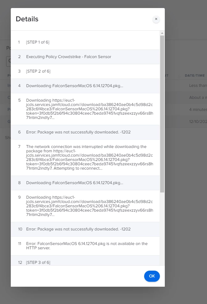

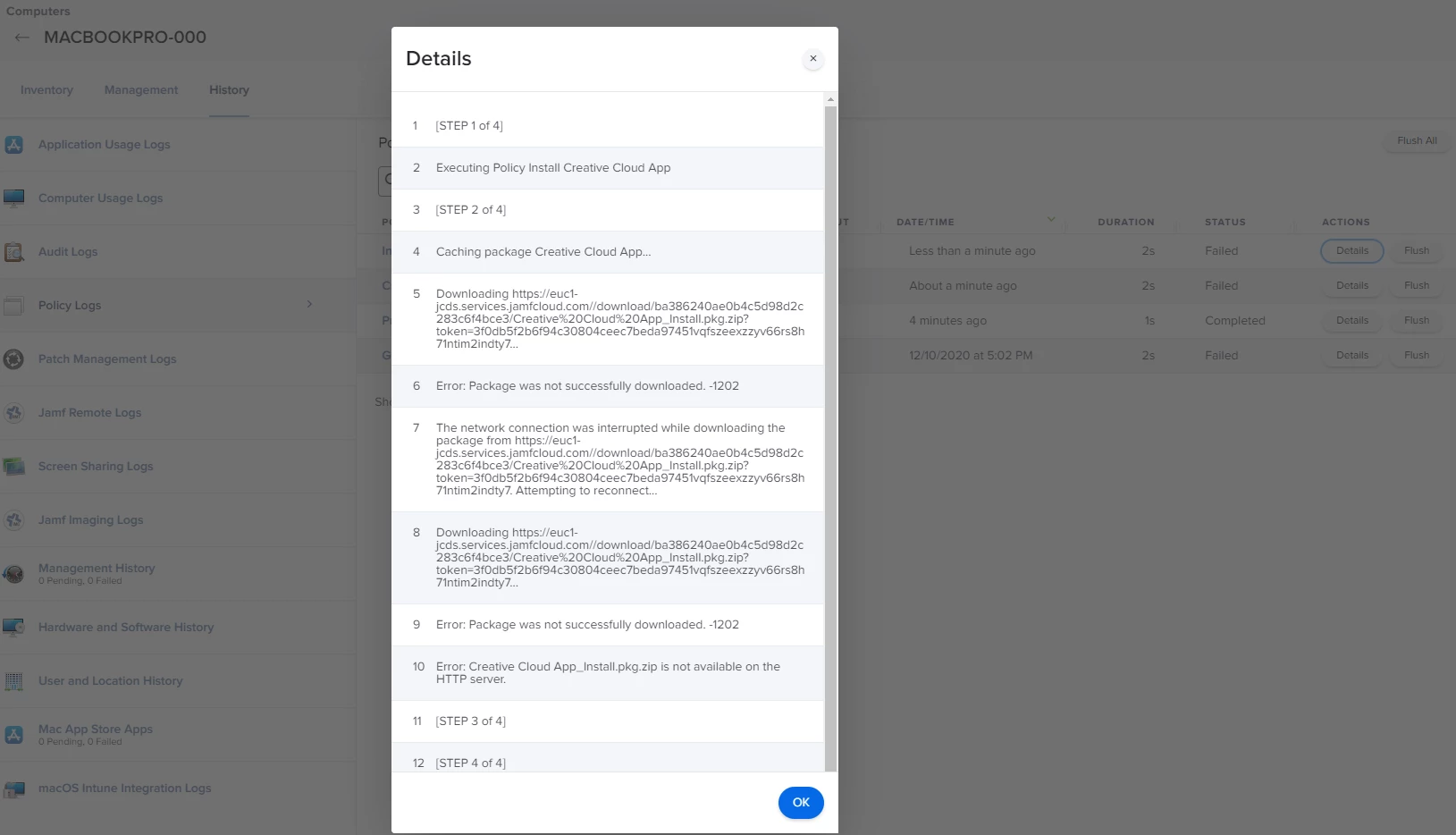

hi,
we're trying to deploy some packages in self service, like adobe creative cloud or falcon sensor.
both of the packages gives back connection errors while downloading the applications, but this is not schematic.
I'm getting crazy trying to understand what is causing this issue.

@alessio.tedesco Are the Macs having this problem connected to a network that does SSL inspection of traffic? If the answer to that is yes, do you have the certificate that traffic is re-signed with after inspection installed on those Macs?
Hi @sdagley ,
looks like that this particular test machine is somehow broken, we used it for deployment tests, I tried with other machines and seems to be fine.
