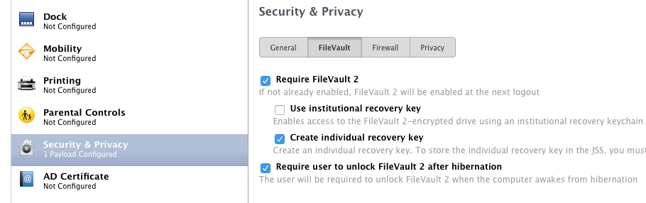

@myronjoffe is the bottom checkbox, checked?
@bentoms yes... FV2 after hibernation is a security requirement... Was going to test this evening if unticked would reproduce the issue.... Seems like you know something already
@myronjoffe FV2 lock is activated by booting into the Recovery Partition on the machine and requiring a FV2 enabled account password to unlock. By enabling "Require user to unlock FileVault 2 after hibernation" you're asking the Mac to reboot after the sleepimage file is written.
@StoneMagnet I understand. So not the same as $ sudo pmset -a destroyfvkeyonstandby 1
@myronjoffe Actually I expect it to be the same (disclaimer - I'm not using FV2 in my current environment as we want network access to Macs without a user logged in), and the unlock process requires going through the FV2 login from the Recovery Partition.
@StoneMagnet i've scripted this command in the past in conjunction with policies for FV encryption and machines do not restart.
@myronjoffe Kills that theory then. Have you looked at the output from pmset -g
to see what exactly changes when the "Require user to unlock FileVault 2 after hibernation" option is set in a configuration profile? Perhaps it's changing something else besides the destroyfvkeyonstandby setting.
