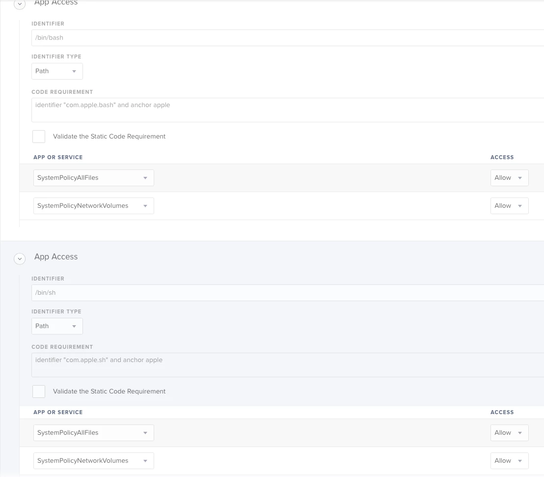

You're going to need to whitelist a few things via a PPPC profile in order for depNotify to work on Catalina via a smb share.

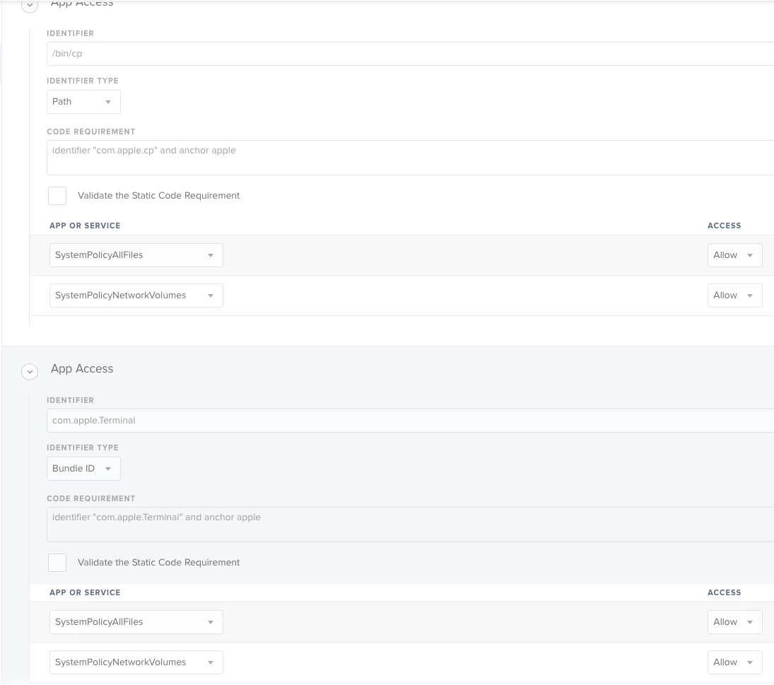

@m.donovan Thank you, Created a supplemental PPPC profile that only applied to Catalina machines.
I did have to add the following:
com.appleTerminal - SystemPolicySysAdminFiles (Allow)
For safe measure I also added (zsh) /bin/zsh to have SystemPolicyNetworkVolumes & SystemPolicyAllFiles - Allow

I'm using DEPnotify with a launch daemon that runs a Jamf policy with provisioning script. The script calls on other policies to deploy packages via custom triggers. Internally using SMB FSDP and just ran into the "CP operation not permitted" issue while working on Catalina and new 2020 MacBook Airs.
Creating a PPPC for /bin/bash and /bin/sh, with allow Network Volumes and All Files did the trick. I did not have to include Terminal, CP, or loginwindow for things to work.
