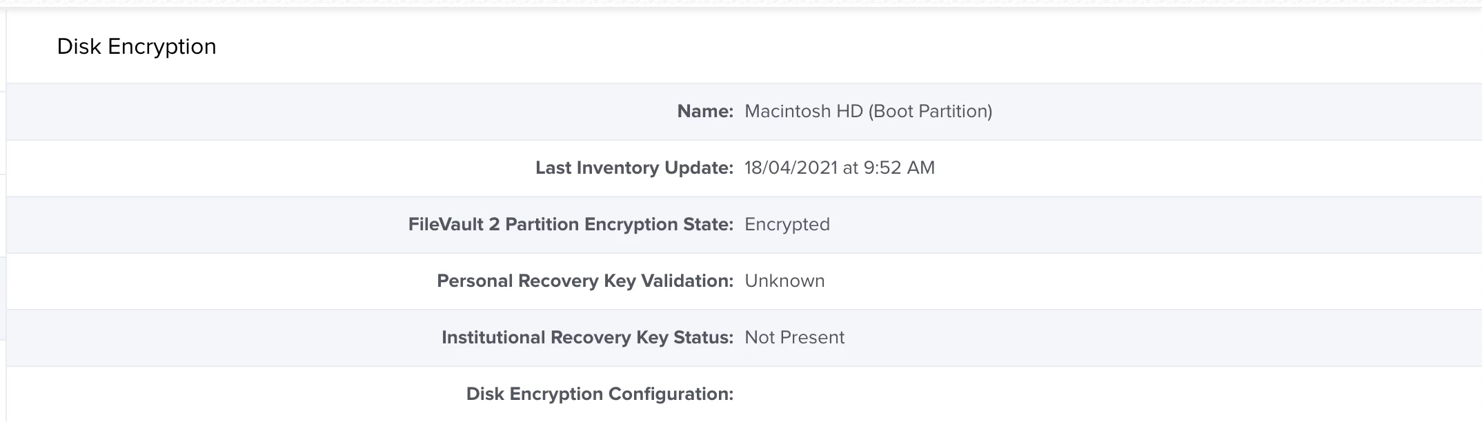

I cant login to one of the mac laptop which is encrypted. If i check the mac on jamf it shows Personal Recovery Key Validation is UNKOWN. I have created a policy on jamf to create a local admin account on that mac by following this https://www.jamf.com/jamf-nation/discussions/31953/add-a-user-account-remotely.
Is there any way to check in the mac so it creates the local admin account.

Unfortunately @Cranappras is correct. When a Mac with FileVault first boots, the OS isn't loaded and there's no network stack, so actually getting the Mac to check into Jamf to run anything is impossible in that state. The internal Macintosh HD partition isn't even mounted until after you unlock it with a valid password or Recovery key.
So in essence, if you don't know a password to unlock it, or have a Recovery key, there's pretty much nothing you can do to unlock that drive to get back into it. The only other option would be if it had an Institutional Recovery key installed, but from your screenshot above, it doesn't look like it does. Sorry, but without that and without the other 2 ways, your only choice may be to wipe the drive and reload the OS.
Thanks very much @Cranappras and @mm2270 for your responses. I will have to wipe this machine and that's the only option i can see.
