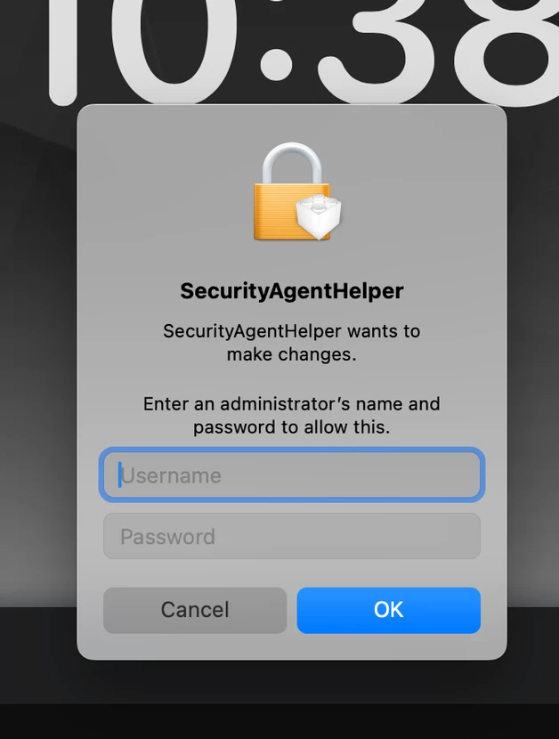

I am testing Connect 2.45 and have had a popup appear on the Login Screen.
Its a really "Helpful" Popup.
All it says is SecurityAgentHelper wants to make changes, and it asks for an Administrator username and password.
None of my users are Administrators, so they will not be able to fill this in.
Is this a bug?
Is there a way to fix it so that it does not pop up?
What process is it that wants this access?
Thanks
Paul

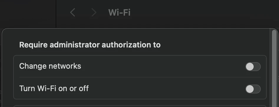

I think this is more on Apple's side. Most of our org devices use Ethernet, but there are a few setups that rely only on Wi-Fi. For the Ethernet setups, we completely disabled AirPort for Wi-Fi, and the prompt seems to only appear on Wi-Fi-enabled devices.
It turns out we also had the "Requires Admin Authorization To: Turn Wi-Fi ON or OFF" setting enabled. After turning it off, the prompt stopped appearing.
I'm currently looking into granting access to the helper via a separate PPPC to see if that resolves the issue. If not, we’ll likely disable this setting across all devices.

I can confirm that enabling the setting "Requires Admin Authorization To: Turn Wi-Fi ON or OFF" is the cause of the popup! I have disabled it, and the popup no longer appears!
Thank you very much!

Late to party on this one. Just started deploying Jamf Connect 3.9.0 (SelfService+). Thus far, I have seen this pop-up 2 times. In both cases we isolated it to the Wi-Fi settings pane  > Advanced settings. When “Require admin...” is checked, then we see the pop-up at login window.
Jamf support confirmed there is a known PI for this (PI134880), which is tied to the network settings on an endpoint. I opened a case you can cross-reference if needed (215471224338746).
“If require administrator is enabled to manage network settings, it will trigger the security agent prompt on Jamf Connect 2.45+. To prevent this pop-up, we can either downgrade JC:L to version 2.44 or build a custom configuration profile with the following settings:

Note: This profile doesn't work for me for some reason. Tested on Sequoia 15.5+ and Tahoe 26.0.1+ and got same results: The restriction isn’t persistent - users can still modify these network settings. Jamf support rep couldn't figure it out. No conflicting profiles or anything obvious. <shrug>.
I also ended up removing the Jamf Connect Wi-fi picker UI from the Jamf Connect login window, too. Its not very useful considering its laggy, doesn't support 802.1x EAP-TLS and doesn't support captive portals. However, disabling the Wi-fi picker still doesn't prevent the pop-up if “Require admin...” is enabled.
