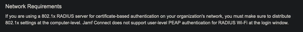

snowfox
  • April 28, 2021
Thanks all for the input. I found this in the Jamf Connect Admin guide.
