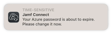

You can use the Jamf Connect Configuration application - which is included in the .dmg - to easy generate the appropriate configuration to not only display the number of days to expiry, but also to use a native notification - as shown below - to prompt the user to change.
Which settings did you configure to show this?
