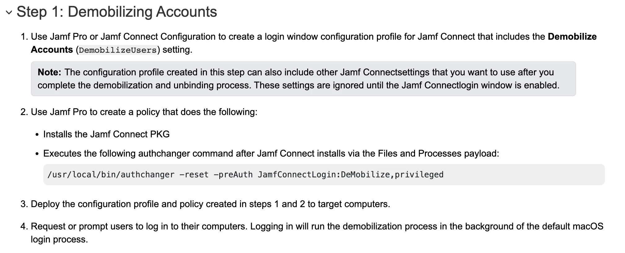

Particularly this part

I'm not sure I understand the issue here... Following the guideline literally defines the mechanism of how the demobilization works.. Once you configure the setting on Jamf Connect, it states the demobilization happens in the background after the user logs in... You can track progress via EA(Extension Attribute)
The scenario is, when its applied, we are rebooting, which is what , to me , is the preferred method and its not demobilizing (sorry if i was not more clear on the issue).  And after reboot is technically logging in but it doesnt demobilize after any of the reboots.
Again, trying to automate this, and forcing a reboot vs. a log off to me is preferred.
