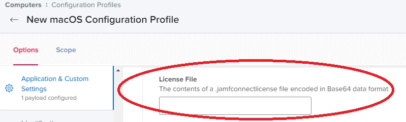

I'm trying to create a config profile with all off the JAMF Connect settings using the new tool they created to do so, but I'm not sure what to but under the License File section. I have the separate config file from JAMF with our licenses but even their support wasn't too sure what to put into that field. Was wondering if anyone ever tried this with any success?

The best way would be to create a separate configuration profile which will just manage the license file by uploading the .mobileconfig file you get from jamf.

As above, jamf sent us a file.
  • June 4, 2020
For our environment .. We found that using a plist and deploying via config profiles is the best / easiest way to deploy license.
