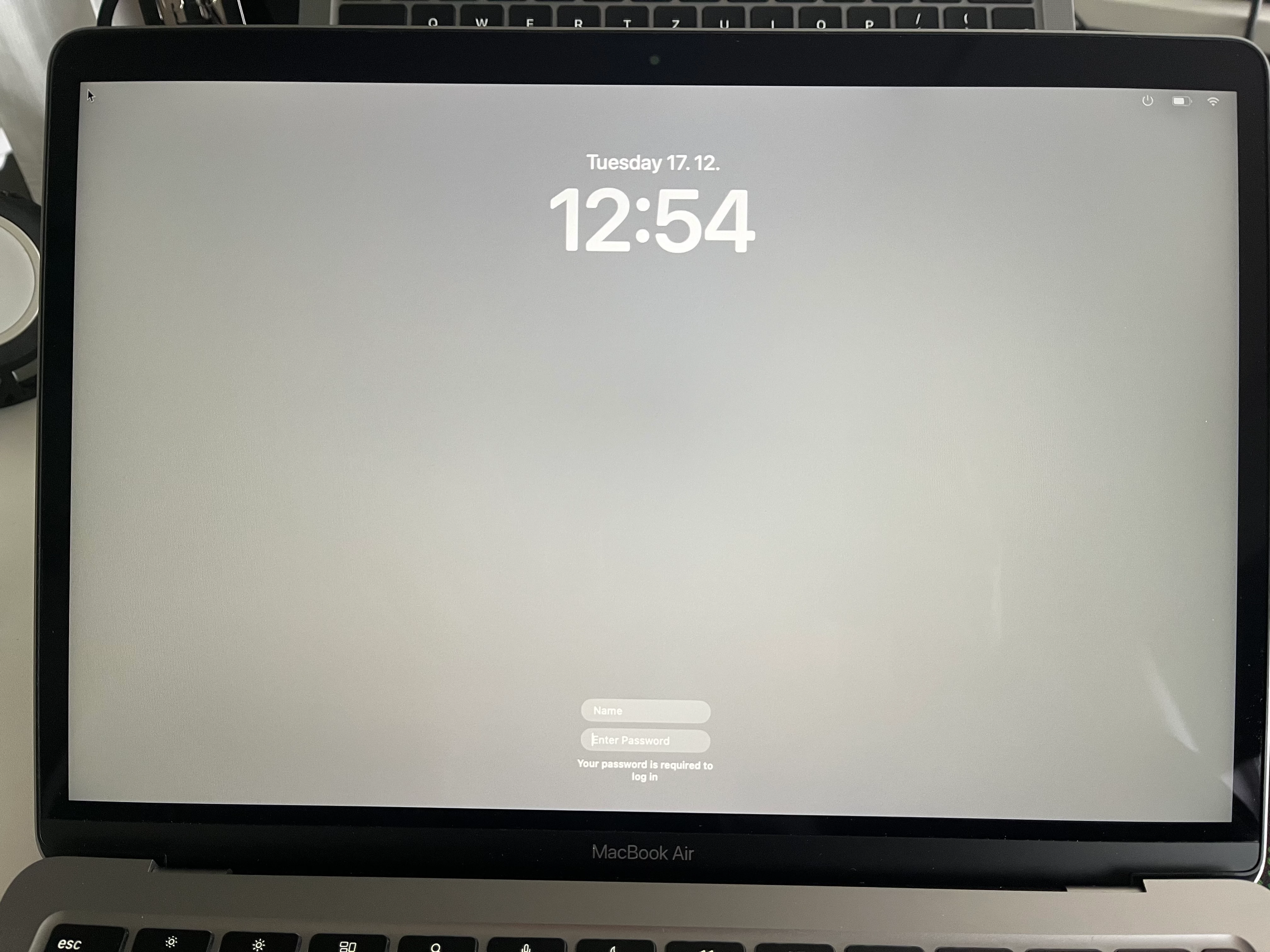

Hey everyone,
I’ve set up Jamf Connect with Google IdP following the documentation and tested it; everything seems to run fine. However, I've run into issues during PreStage Enrollment deployment in Jamf Pro. I can’t seem to launch Jamf Connect properly for local account creation to show the Google login screen. Right after the Setup Assistant, it only shows a black login screen with empty fields for user and password. According to troubleshooting, it might be due to the permissions in the package, but since I’m using the official Jamf Connect 2.42.0 package and distributing it through Cloud Distribution Point (Jamf Cloud), I don’t think there should be an issue.
Has anyone had a similar experience and found a solution?
Here is my configuration excluding secrets:
<key>AllowNetworkSelection</key> <true/> <key>CreateJamfConnectPassword</key> <true/> <key>CreateNewUserHide</key> <true/> <key>DenyLocal</key> <false/> <key>EnableFDE</key> <true/> <key>EnableFDERecoveryKey</key> <false/> <key>Migrate</key> <true/> <key>OIDCIgnoreAdmin</key> <false/> <key>OIDCNewPassword</key> <true/> <key>OIDCProvider</key> <string>GoogleID</string> <key>OIDCRedirectURI</key> <string>https://127.0.0.1/jamfconnect</string> <key>OIDCUsePassthroughAuth</key> <true/>

  • Dec 17, 2024 12:09 PM UTC
It really looks like the package didn’t even install. Account creation was skipped and admin account was hidden from the user as configured in the prestage. I tried deploying connect version 2.41.0 with the same result.

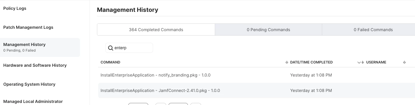

A_Collins
  • Dec 17, 2024 10:44 PM UTC
Check the management logs. Under history of management logs, you would see something like this if it is installed.

  • Dec 19, 2024 11:54 AM UTC
Yeah, well the log shows the entry and it’s not failed, but I think the application still isn’t running or maybe it didn’t even install.
