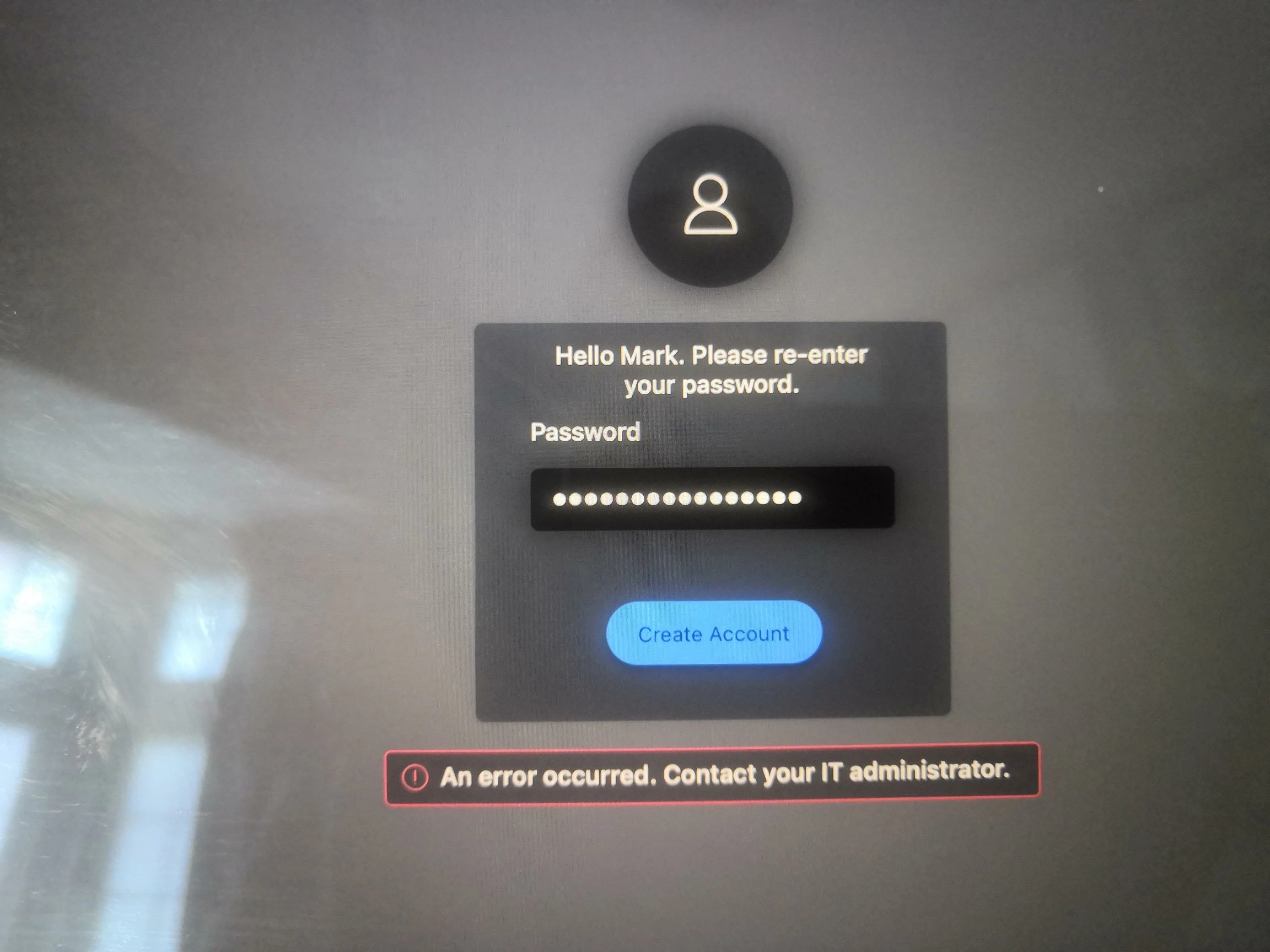

Then I get a prompt, "Hello (User).  Please re-enter my password".
I can see that this is pulling the correct User from Azure because I've changed the claims to verify this and I get a different value for the User in this prompt which matches a different attribute in Azure.
After I enter my password in again, I get a message, "An error occurred.  Contact your IT administrator".
It isn't the most helpful message that I've seen!!

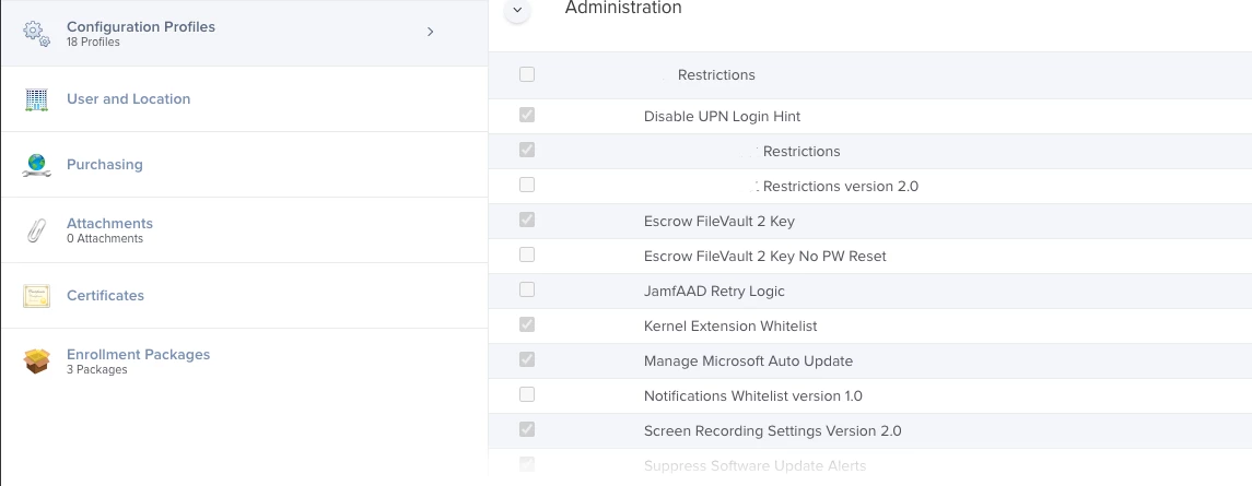

You can add profiles to the PreStage to ensure they are installed immediately upon enrollment. Then make sure those profiles are scoped correctly to stay in place after enrollment completes.
bwoods
  • August 4, 2021
@Smadakram0 , @emily  is correct make sure that your configuration profiles for Jamf Connect are checked for immediate installation.

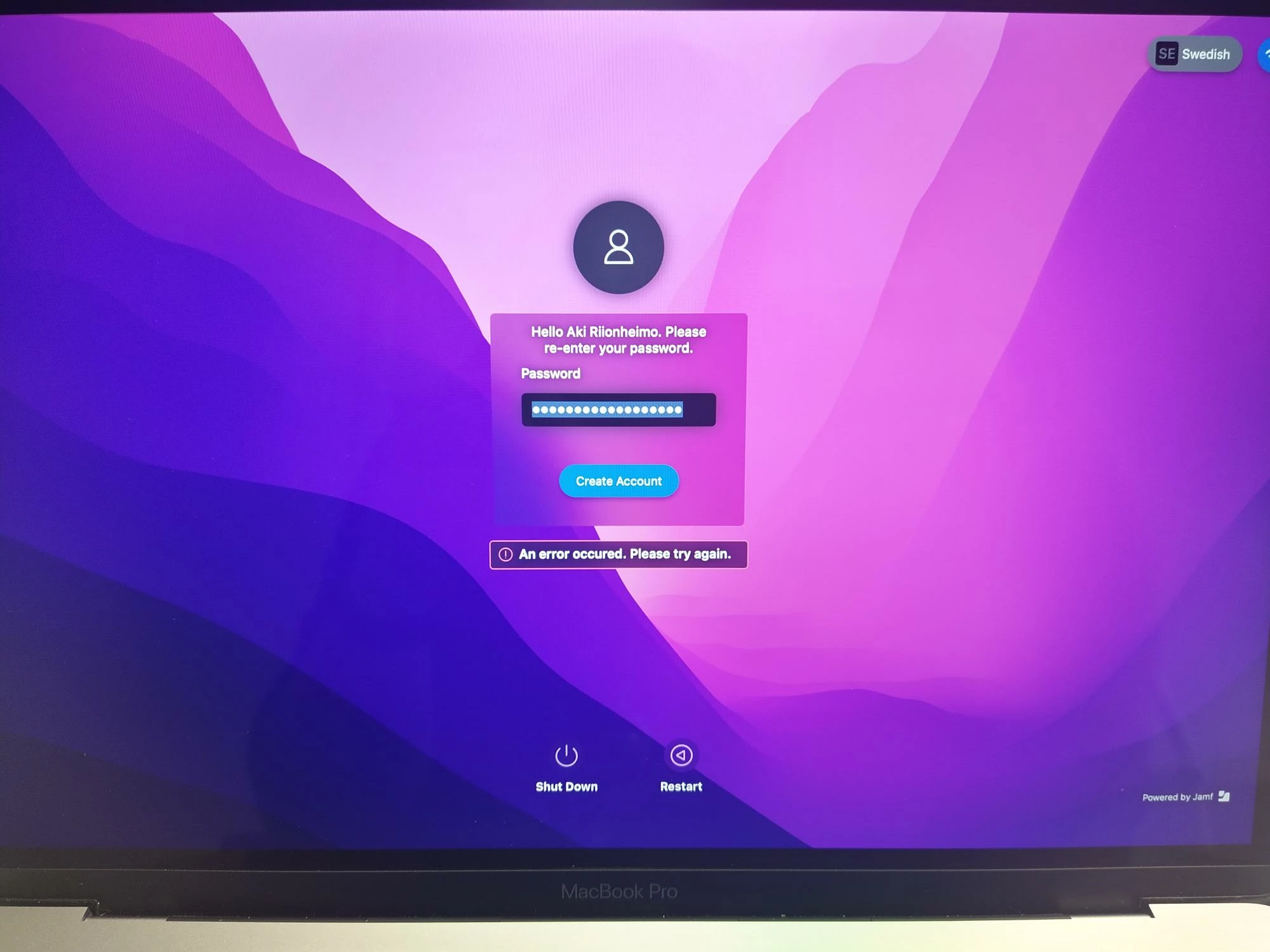

Hello @Smadakram0 @bwoods @emily I have the same issue, after starting the Prestage enrollment Azure Login will happen, and after that, it will pick up the correct user name but when the user puts in the same password it will not take.  "Enable Jamf Pro to pass user information to Jamf Connect" enabled - where I can find this? Please help. The configuration profiles are selected in prestage enrollment.
iamsumanaddya
  • January 27, 2023
@Smadakram0 I have checked that. in our SSO "Enable Jamf Pro to pass user information to Jamf Connect" enabled" - it is enabled. But still suddenly create account part is not accepting the user password. But I can see that this is pulling the correct User from Azure.  Please help.
