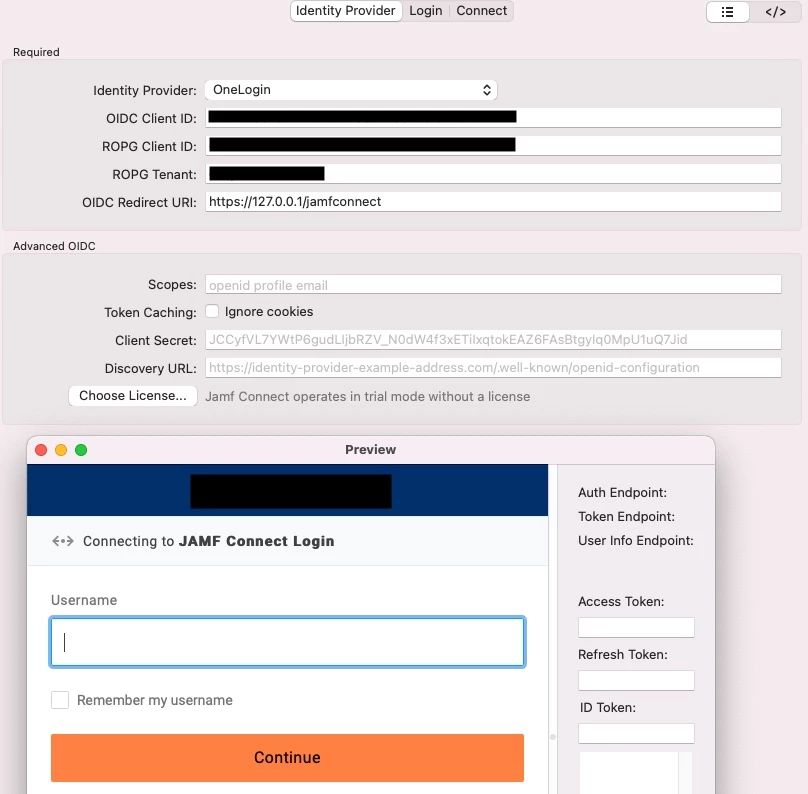

Hello :)
because I'm still struggling with Jamf Connect for testing Onelogin. I'm using the latest version of Jamf Configurator (2.9.0) Please note, for my test instance, I didn't configure MFA for Onelogin.
I don't know if it's the OIDCTenant or something else why it's not working but I tested already these things for OIDCTenant.
Error message from Jamf Configurator: " Unable to load Identity Provider "
Error message from Onelogin: "OIDC authorization code for Jamf Connect FAILED"

Best answer by Flaurian
What was your OIDC test result in the Jamf Connect Configuration? We use the most basic setup.
Thanks, @YanW I solved it finally with the Jamf Support team. It looks like for me, they missed keeping the Onelogin documentation up2date.
In case, u configured OneLogin as an OIDC connection u have to change the authentication method to "POST" not to "none". Afterward, I got tokens and I configured also ROPG / Discovery URL / Secret

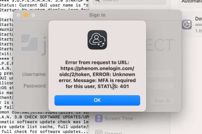

  • Oct 9, 2023 3:05 PM UTC
Hello Everyone,
When we signed into Jamf Connect menubar we're getting MFA error, does anyone have a idea about this error.
Attached the screenshot for reference.
  • May 13, 2025 5:08 PM UTC
Hello Everyone,
Is any one else still having trouble with this.
The one thing that I think I am getting stuck on is where do I find the Tenant line.  I have all the other boxes fill out and have the authentication set to Post.
