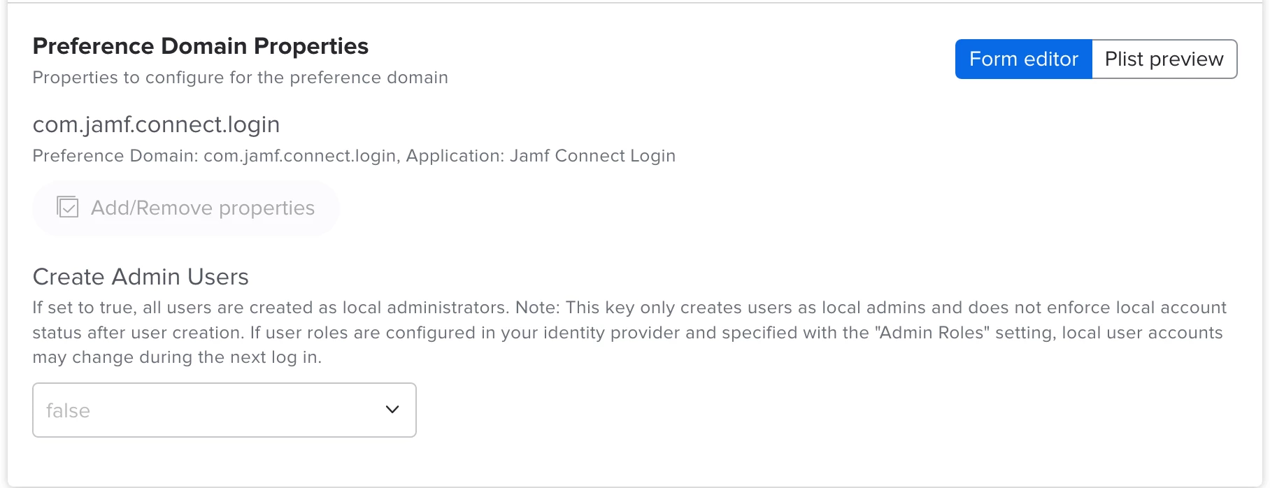

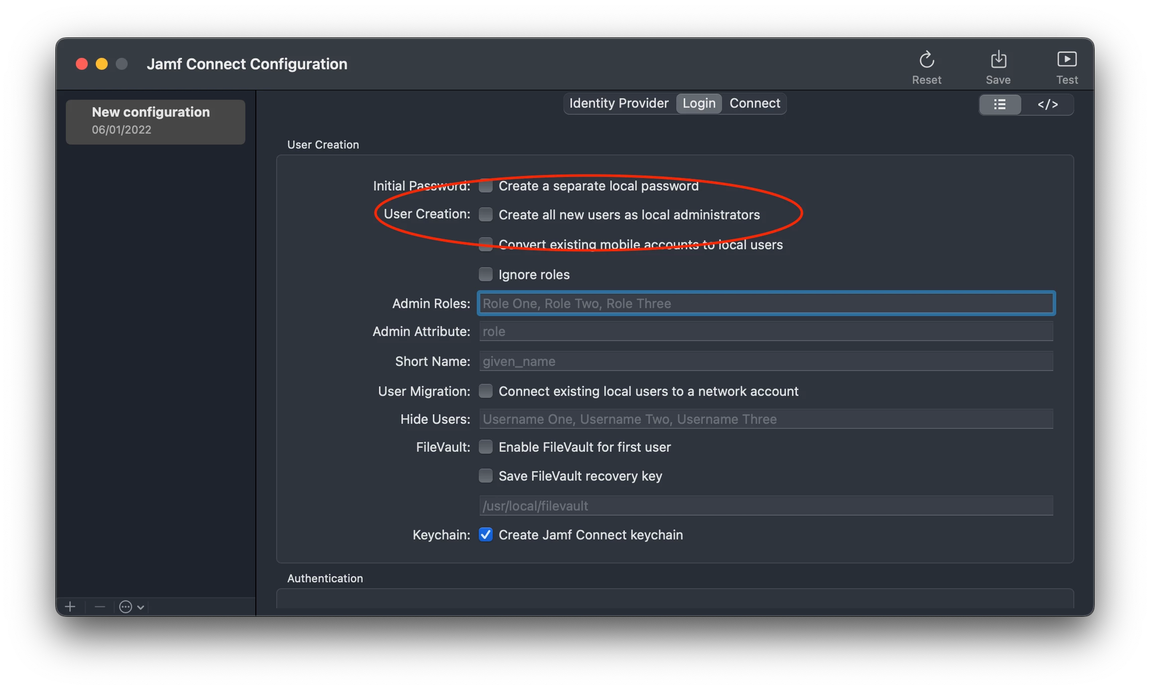

So in the 'login' configuration profile there is a key to determine whether you create the users as an admin or not from the start
<key>CreateAdminUser</key> <false/>
If you use either the Jamf Connect Configuration app or when creating a config profile in Jamf select Application & Custom Settings > Jamf Applications you can just configure all these options in the GUI and have the plist/keys written out for you automatically (if you're not already). See the attached screenshots for examples.
Hope that helps.
