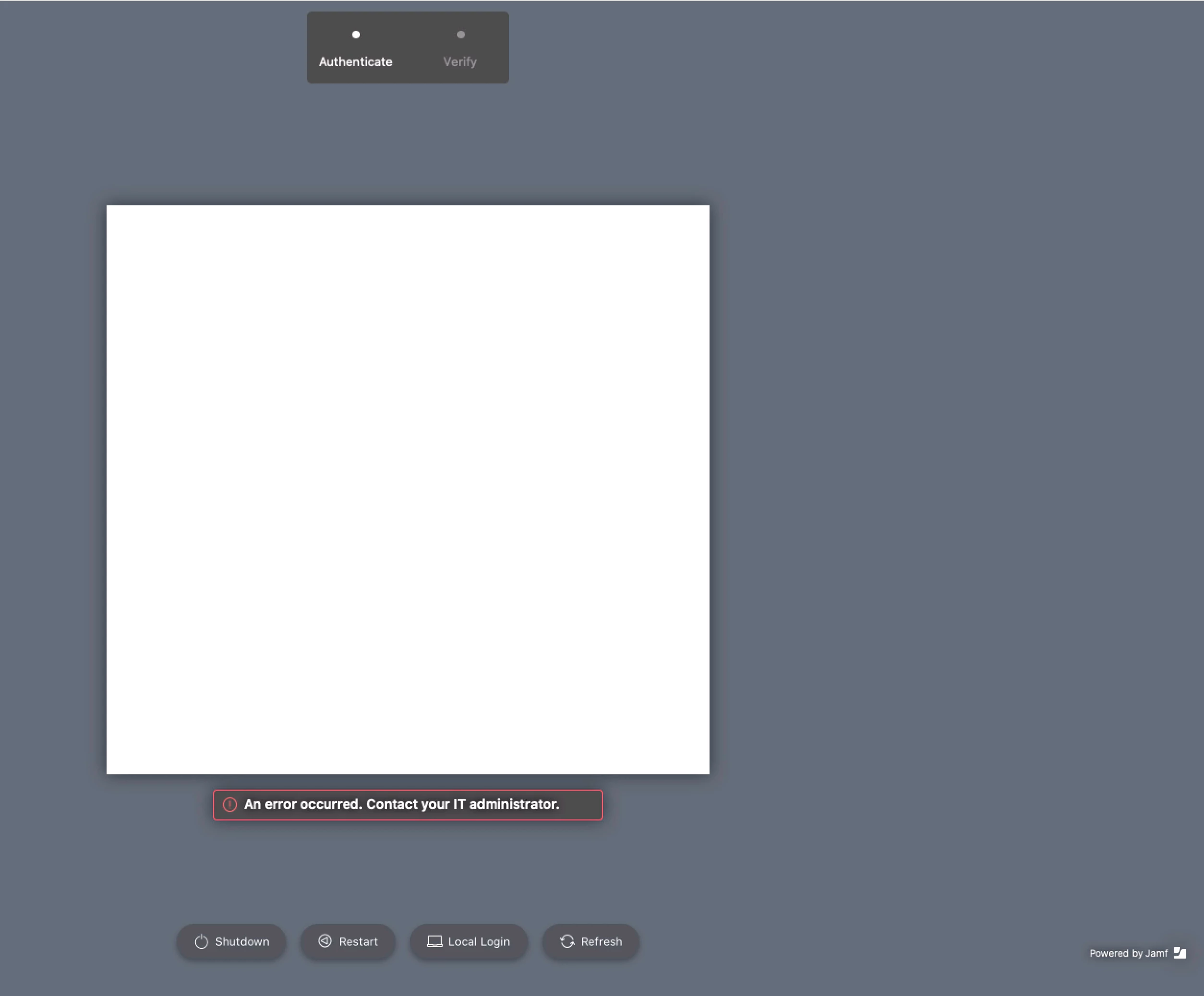

I get no logon window for Microsoft AD when I reboot the mac. I can only logon locally with my mac user.
Any ideas where it's failing?

Are you seeing the FileVault login screen instead of the actual macOS Login screen by chance? If you enter your password at the FV screen do you get the Jamf Connect Login screen afterwards
if that is not working, login to your Mac and run the following command:
sudo /usr/local/bin/authchanger -reset -JamfConnect
That should enable the JamfConnect Login window.
  • February 11, 2021
Ok so running that command I now get the jamf login screen. Wohoo! Something else has gone wrong as you can see. I'm going to re-create the configuration profile as I've been messing around with different configurations and maybe I broke it and thats why its erroring out.

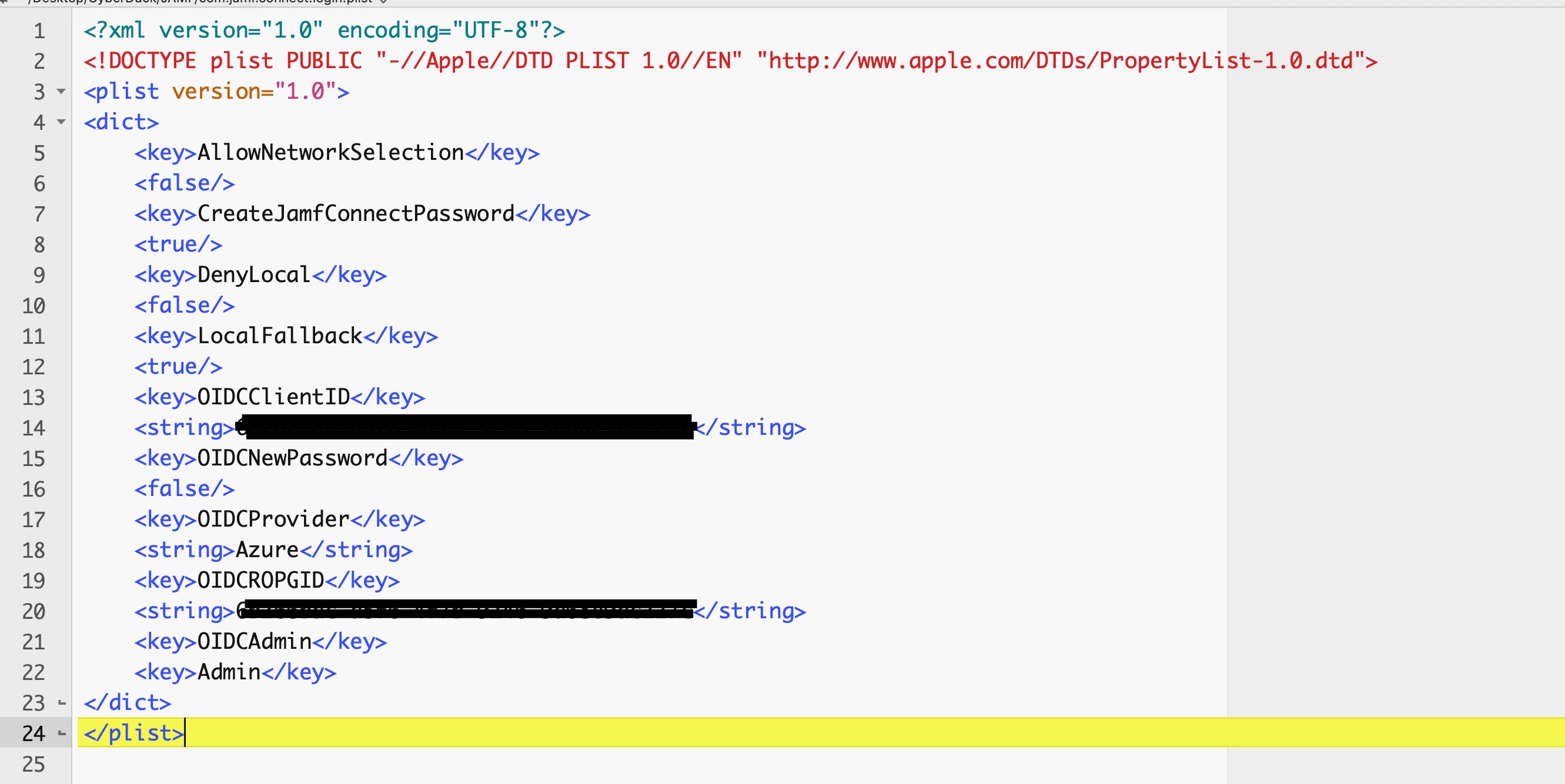

Right, after recreating everything and checking for typos its now working :) The only thing that not working properly is it not getting the roles Admin from Azure AD. I've updated the manifest in Azure with the amendments from the Jamf Connect user guide. My test user is in the admin group in the enterprise application. When goto the mac, users I see the AD user created but as Standard and not admin.
Any ideas? Is my plist good?

Looks like you need to add the following entry:
<key>OIDCAdminAttribute</key>
 <string>roles</string>
That key is required for Azure AD, in addition to the OIDCAdmin key listing the role(s) that should be created as Admins.
