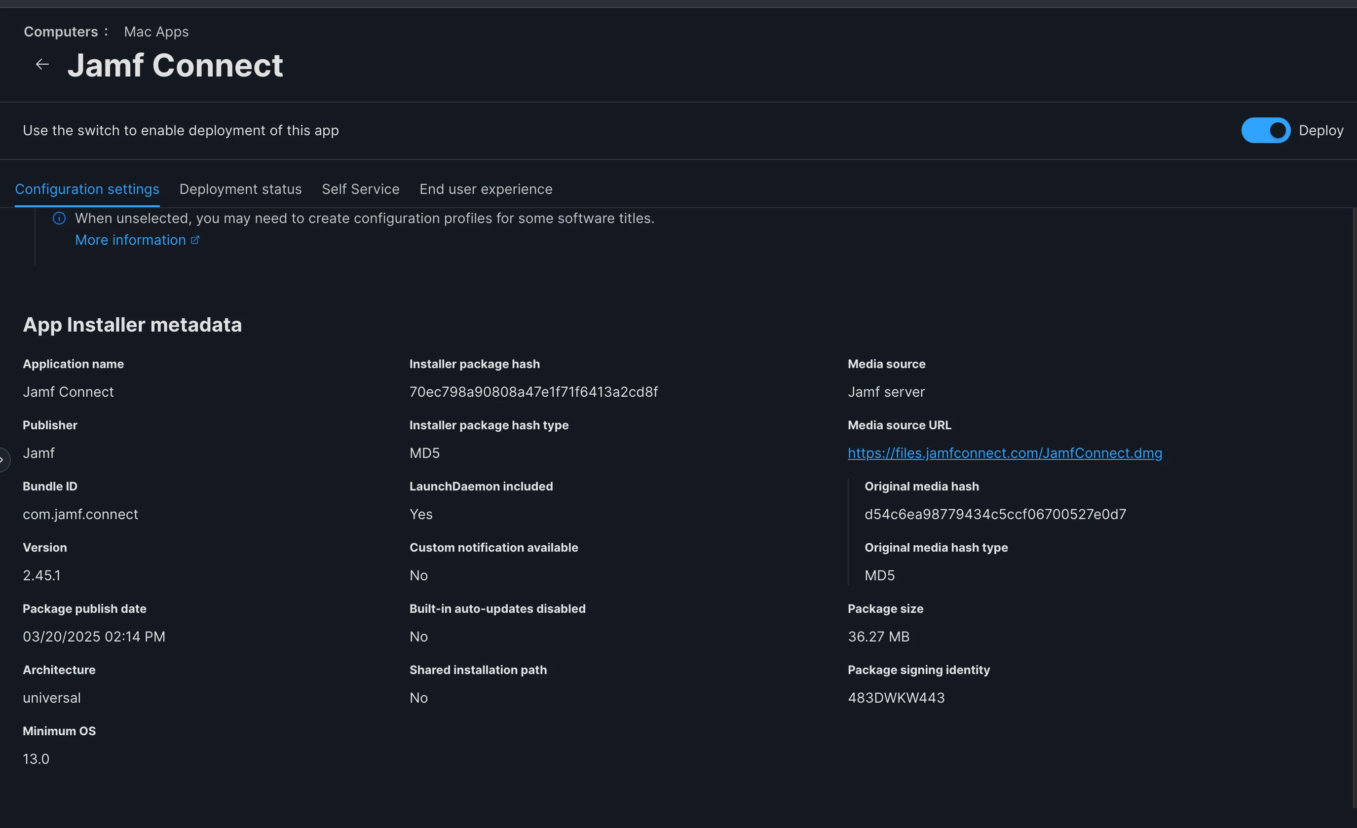

This also lines up with what I’m seeing on our side. At the moment, the legacy Jamf Connect 2.45.1 suite is still scoped to all managed clients, which explains why the old menubar component keeps showing up even on devices that already have Self Service+ and the newer JC Login.
It’s also worth mentioning that our Jamf environment hasn’t really been touched for about three months because there was no administrator in place. I’ve just stepped into this role and I’m trying to get a clear picture of what should (and shouldn’t) be deployed going forward.
Just to confirm that I’m understanding this correctly:
The item shown in my screenshot the old “Jamf Connect” menubar app shouldn’t be deployed automatically anymore via Mac Apps, correct? Instead, Self Service+ replaces that part, and I should separately deploy the latest JC Login PKG.
So the ideal state for our environment should simply be:
Self Service+
Jamf Connect Login
And no legacy JamfConnect.app menubar components, right?

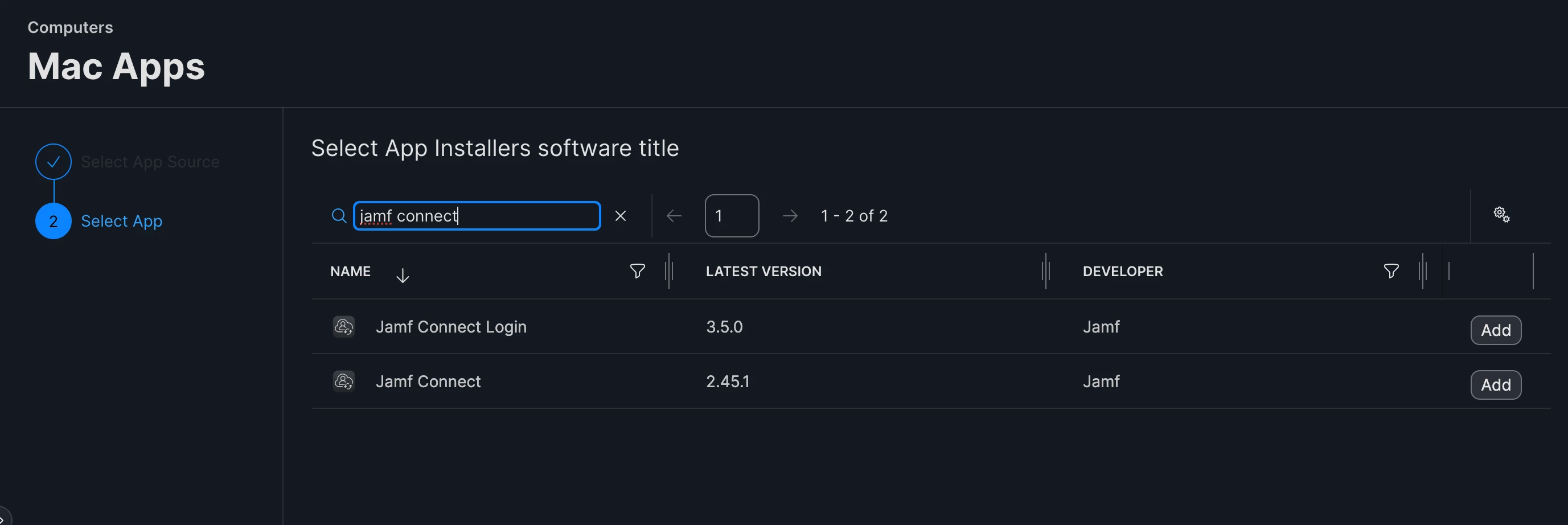

Josh-Q
  • Nov 19, 2025 2:03 PM UTC
​@paczo Yeah, so moving forward, you would disable the “Jamf Connect” deployment and instead turn on the deployment for “Jamf Connect Login.” Self Service+ will be kept up to date automatically by Jamf Pro, so nothing special needed there. Self Service+ will take care of the Jamf Connect menubar functionality moving forward.

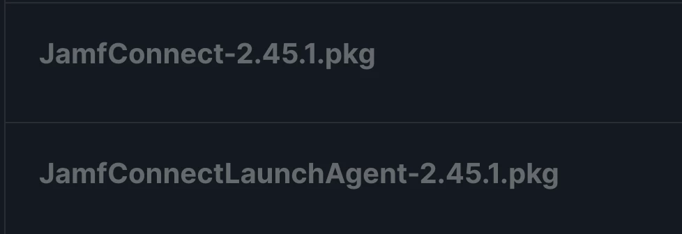

Well, but i can see that i need to do one more thing, because during the prestage enrollment, those packages are being deployed.
Any advices how to deal with it, what should i replace it with?
Josh-Q
  • Nov 19, 2025 2:43 PM UTC
​@paczo  Remove those and replace with the latest JamfConnectLogin.pkg that you can download via your Jamf Account dashboard. Current version for that is 3.5.0.
