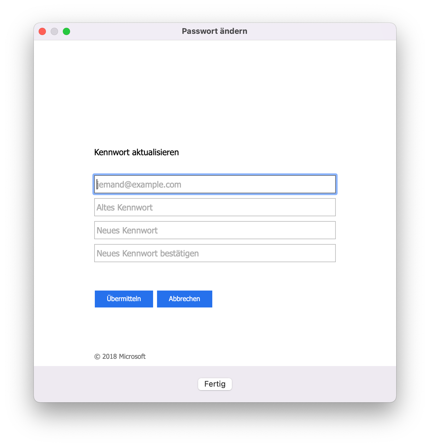

We currently have the problem that when we change the password via jamf connect we do not always get the correct password change window. This is how it should look right:

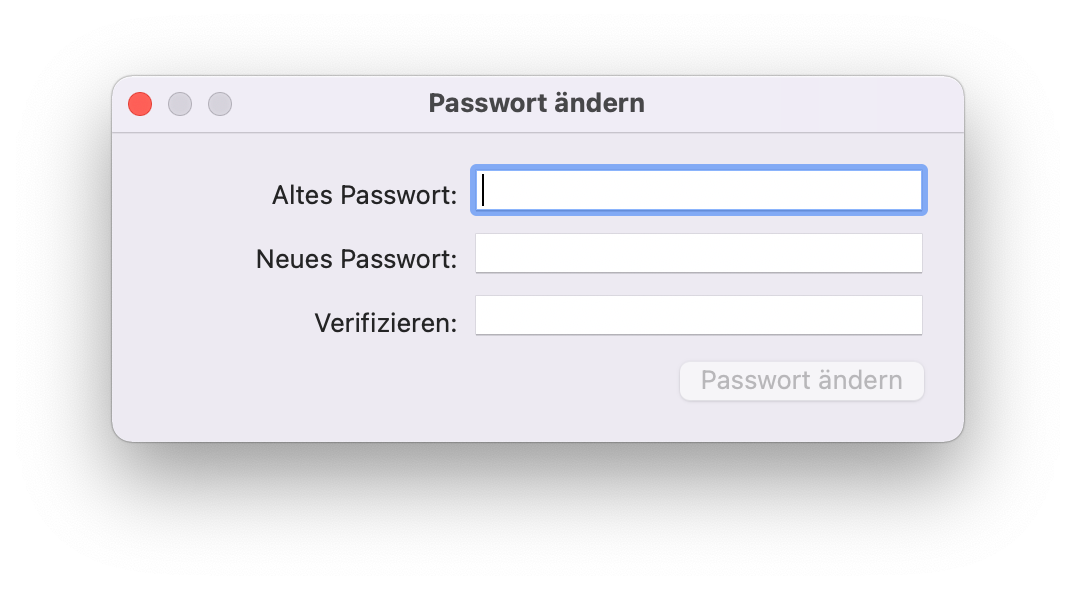

and this is how it feels 50% of all cases.
We are currently using jamf connect 2.3.2
If I briefly disconnect and reconnect the active network connection in the settings, I get the correct window.

If you have setup the Jamf Connect Menu Bar app to connect to the AD domain, it tries to get a Kerberos ticket. (The "Kerberos Preferences" section)
If the mac manage to get one, then you will always have that unwanted window.
On the other hand if there's no kerberos tickets, you will get your IDP's window.
So if Kerberos is not needed, try removing these parameters and try again.
Here's some commands to help you troubleshoot this:
- klist Will list every Kerberos ticket your mac has.
- kdestroy -a will destroy every kerberos tickets your mac has.
This is only from my experience, but maybe this is caused by something else than Kerberos.

This is expected behavior. I can assume that you have Kerberos setup on your Jamf Connect. If JC sees a Kerberos ticket, it will present the basic password change dialog box instead of the iDP box.
In someways this can be a good thing. Using Kerberos (and AD) to change the password is much simpler for the user as both the AD and local password get changed at the same time. When you use the iDP change, you are changing your password only in the iDP. The user then gets prompted to login again and change their local password.
But, from a user experience, it can be disconcerting to have two different work flows. There is an open FR to force a password change only through the iDP even if there is a Kerberos ticket.

thx. that was a good link. it seems that we have both options configured in the config profile. kerberos and iDP. thats why we got both windows. we are blocking that users are able to change their password in system preferences - user & groups. so if the kerberos window appears the change doesn't work. i deleted the kerberos part in the config profile and i'm getting the iDP window only, right now.
