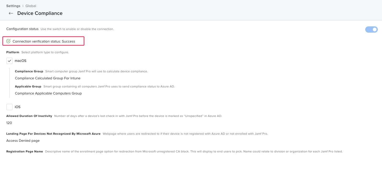

I am struggling since multiple weeks with this new feature device compliance in jamf PRO und Azure Compliance.
Everything is setted up like described here: https://learn.jamf.com/bundle/technical-paper-microsoft-intune-mobile-devices-current/page/Configuring_the_Intune_Integration.html
The connection between jamf and azure is fine. Partner Device Managament in Azure also fine.

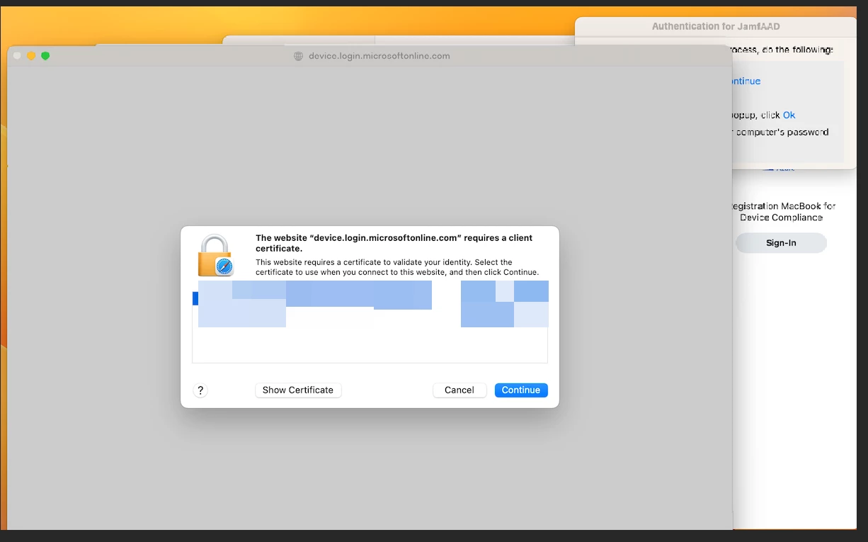

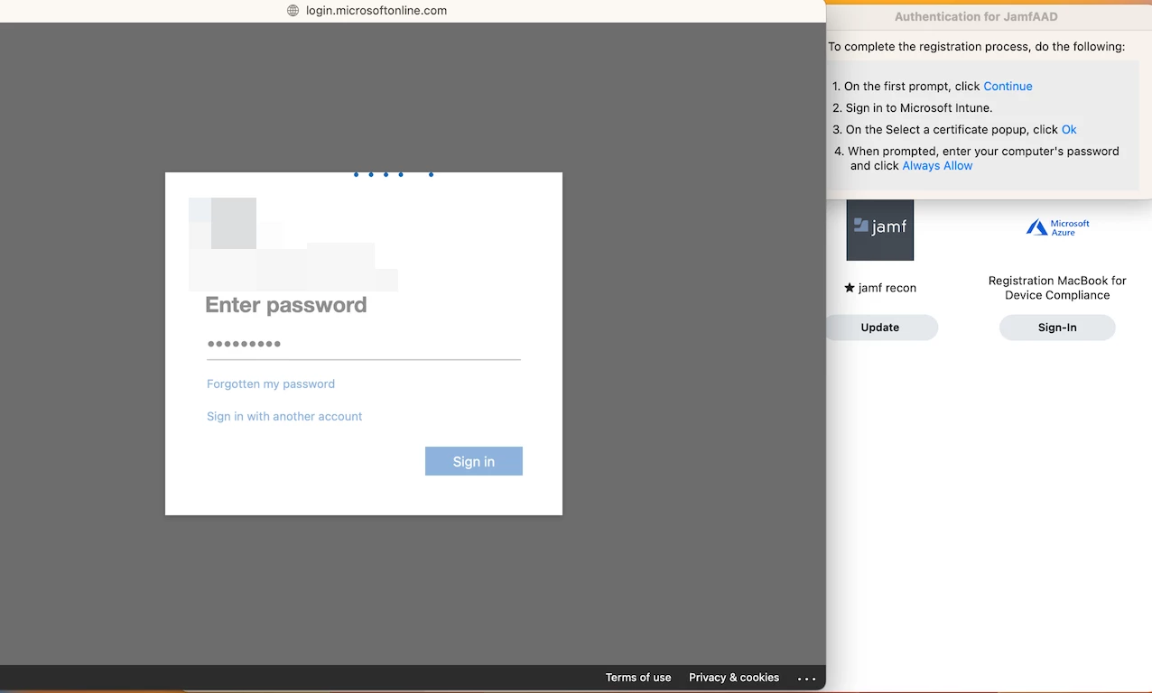

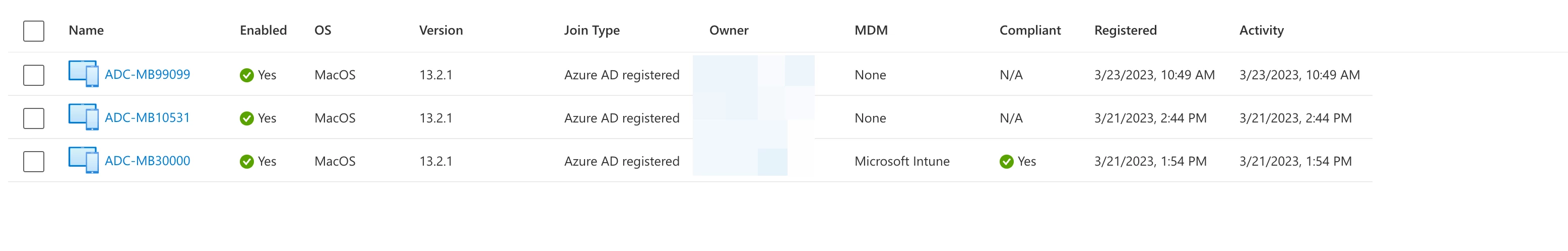

  1. one device (my productive) is the only one which was running the complete registration with company portal and jamfaad (jamf conditional access app) completely and the registration process was done completely with the steps in this screenshot
  2. all other devices are not running
  3. i tried all other device multiple times (after clean install of macos) with my user, with another testuser, with another productive user from 2 colleagues

My device is the only one in azure which is correct registered and shown as compliant. This becaus my device is the only one, which was capable to finish the entire registration process

might be unrelated but did you use the "all users" button in intune when setting up the device compliance ?
if yes, you need to use a specific group otherwise it won't work as per doc

@jpoirson We have a specific group configured. :)
