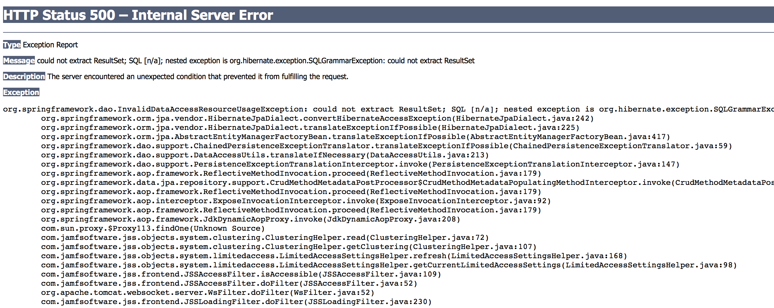

Thanks guys that did the trick! Although now that I'm past that, it looks like there's a mysql problem, although I followed the Linux jamf installation guide. When I go to https://myjamfip.com:8443, I run into the following screenshot.
Does any of that look familiar to you folks? When I did some cursory googling most of the results are unrelated to jamf, or a similar question from a year or so ago that wasn't answered.
  • 6 replies
  • July 24, 2018
Nevermind, managed to figure this one out with some server.xml configurations for running behind a load balancer.
