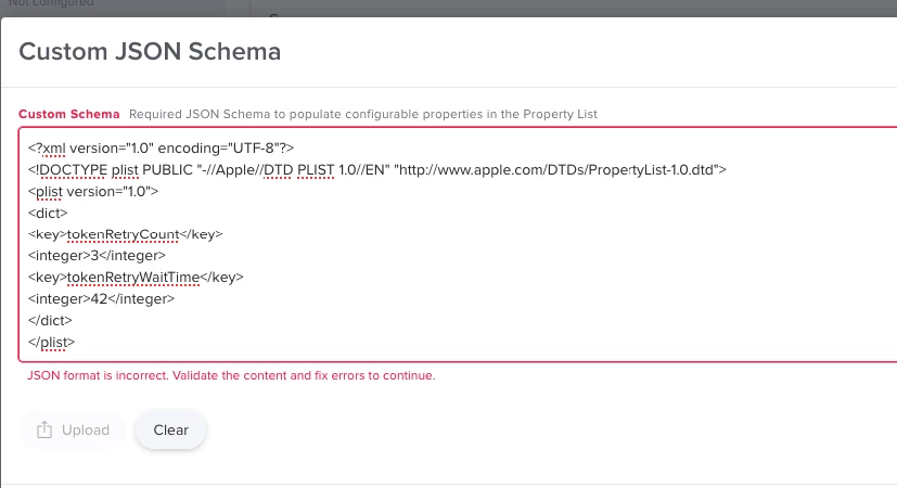

@Matt_Roy93This is great! Thank you so much for getting back to me quickly. I believe the users have fully interacted successfully with the steps in step 1, although some users may not have had their browsers set to Safari but are showing up successfully in Intune.
I believe I'll need to do step 2 in your recommendation, but am very new to Jamf Pro so may need a little bit of guidance on how I set that up, would you mind taking a look and seeing what I'm doing wrong here?
Sorry For my Minimal knowledge of this.

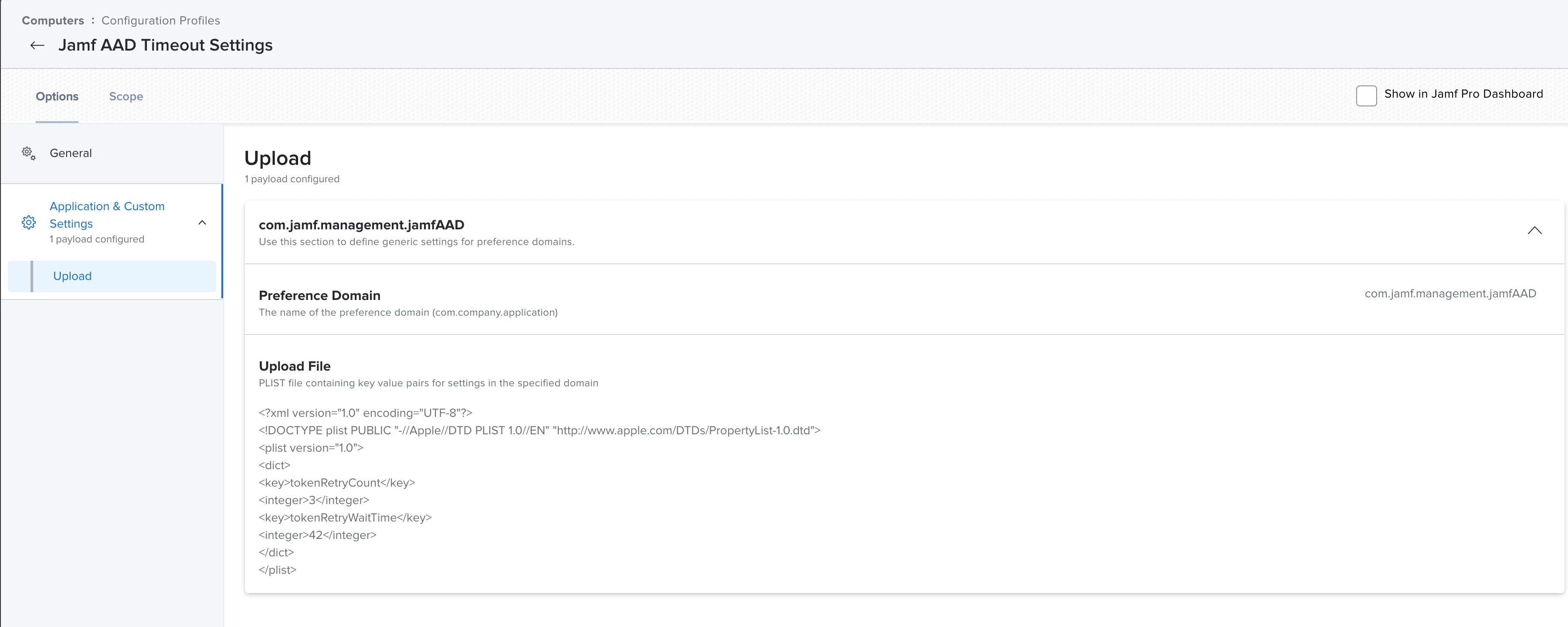

No worries at all, happy to help!
You will want to create a new config profile inside Jamf, select the Application and Custom Setting payload select upload fill out preference domain and paste the plist example I had posted above, make your edits to the values for<key>tokenRetryCount</key> and <key>tokenRetryWaitTime</key> , you will need to experiment with these values to find a balance between removing the pop-up frequency but also having the machine check in with AAD. Name the config profile and save it with correct scoping for test machines.  I will also attach a screen below.
@Matt_Roy93Thank you So much, I'll work on that! I greatly Appreciate all of your help!
