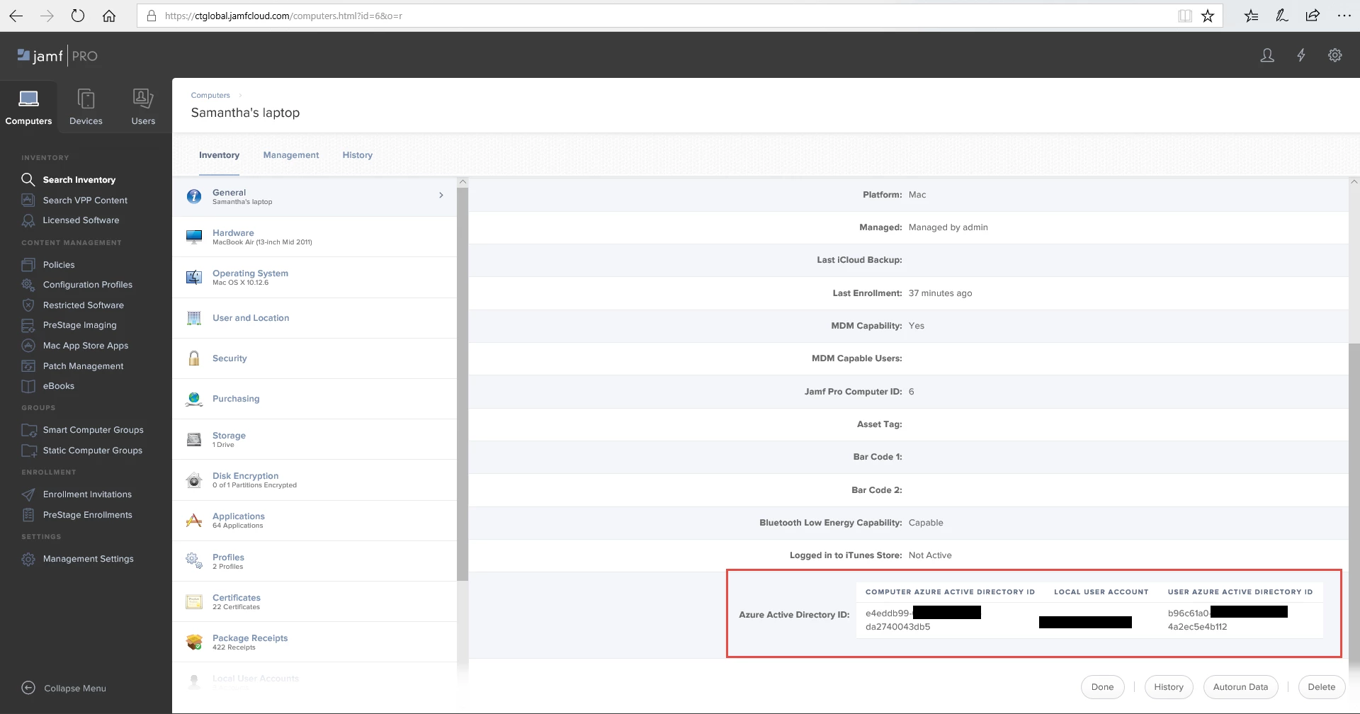

Hey @txhaflaire ,
can't see this in JamF. (attached Image) Everything else looks the same as you have described it.
In intune my mac is shown as uncomplient.
Do you have any idea what i can do?
Best regards
Felix
Okay. One Device now is shown as complient, the other one isn't.
Non of them are shown in jamf like in the picture above.
