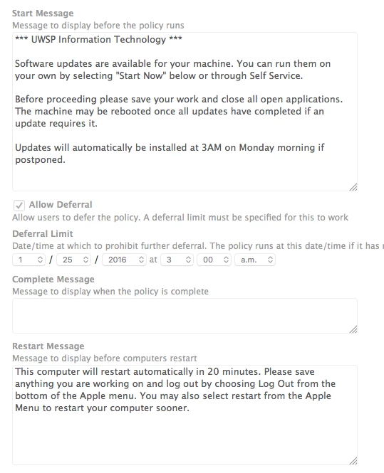

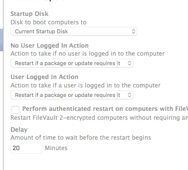

I updated the original post with line breaks. Here are some pictures of how I have the policy setup.

@snovak in my experience, using the Restart Options payload delay has that delay countdown only starting once the OK button is clicked. Some of my end users have figured this out. To prevent their computer from restarting, they just leave the dialogue message up on their screen until they are ready to restart the computer. I think in the way you are using it, the behavior is expected.

All this particular policy is doing is installing apple software updates, and then rebooting if it's needed. We hand schedule it for the 3rd weekend of every month, giving users the option to defer the policy until 3AM the following Monday.
The JamfHelpers are all initiated by the User Interaction tab of the policy, I'm not firing them off manually. I'm believe the one talking about reboots is fired off by the jamf reboot -message.
