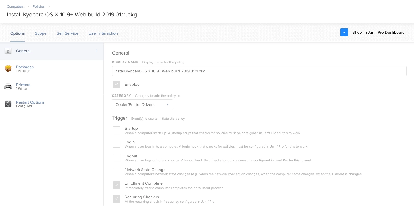

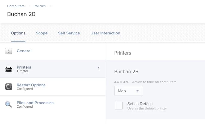

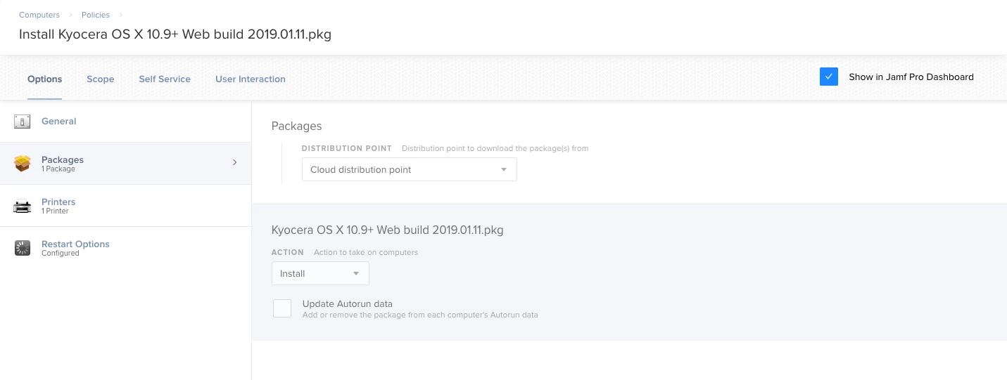

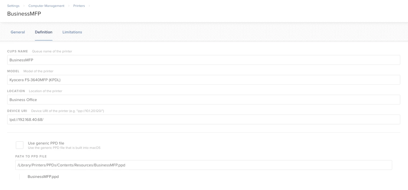

I have uploaded some screenshots.
The first is the printer definition that I uploaded from my workstation. You can see that this specifies the PPD file to use.
The second is a policy that just maps a printer.
The remaining screenshots show a policy that installs the printer driver and maps the printer.

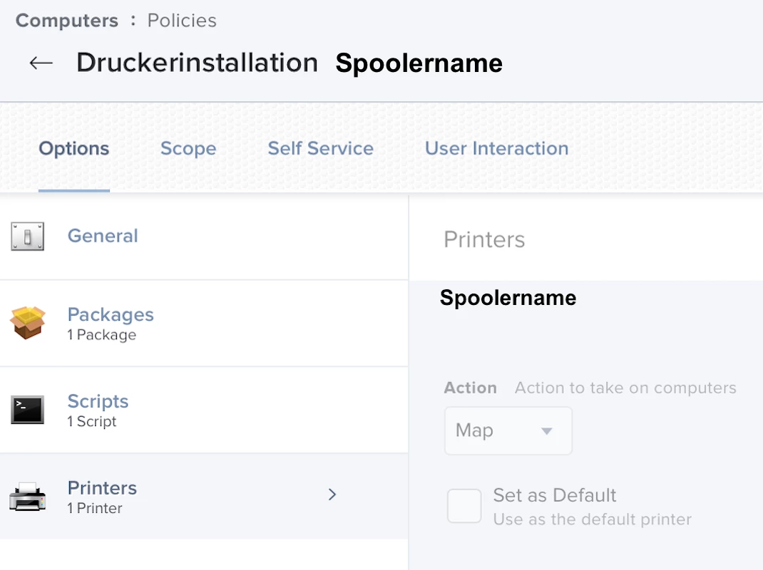

@adminNWA Thank you very much for your great howto for deploying printers with JamfPRO. It works great !
One issue is faced, after the rollout of the printers :
We are deploying printers via a smb share to our (windows) print server.
Mapping manually the printer is, to install the Kyocera Mita printersoftware (the drivers) open the system settings, go to the printers dialogue, add a printer via smb and apply. After that, the mapped printer is shown at the left part of the printer dialogue.
When I am deploying the printer with the same settings (install the driver package, set the path to smb://...) the printer is shown, if I want to print something (for example a website) but it is not shown at the system settings, printer dialogue.
If I remote the MDM Profile, the Printer is shown.
Is there anyone able to help me to get the mapped printer show while the MDM profile is installed ?

@pueowe are providing the printer installation, too via the selfservice.app. It is the "main installation", the user could choose, if it would be necessary to reset the printer system and install the spooler again. The selfservice policy,  re installs the printer drivers on the client and the spooler is mapped to the client. Before mapping the spooler, the little script below is checking in the background for some parameters, so the right spooler server will be mapped.
Script:
#!/bin/sh for PRINTER in `lpstat -v | grep 'smb://' | awk '{print $3}' | tr -d :` do lpadmin -p $PRINTER -o auth-info-required=negotiate done exit 0

  Thanks for your script, Just curious is there any reason you didn't add printer drivers.
Thanks
  • November 14, 2022
Thanks
Hi @yeyo , as you can see on my screenshot above, the job contains a package  for installation, too. This package deploys the printer drivers to the client. We have the same printers at all locations and buildings, so we only have to deploy one driver to the client.
