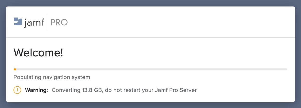

However, in watching the cluster master start up again, the Jamf Pro Startup showed the cluster master again appearing to attempt to make database changes...
Warning: Converting 13.8 GB, do not restart your Jamf Pro Server
Of course, I found this odd...but again, it proceeded through and Jamf Pro started without issue. I restarted Tomcat again, and the same message was presented...it seems perhaps a database table did not update properly?
I did run a mysqlcheck on the database, and all tables reported that they came back OK. However, the mobile_device_installed_certificates table seems to match the size of the 13.8 GB being reported at Jamf Pro Startup.
