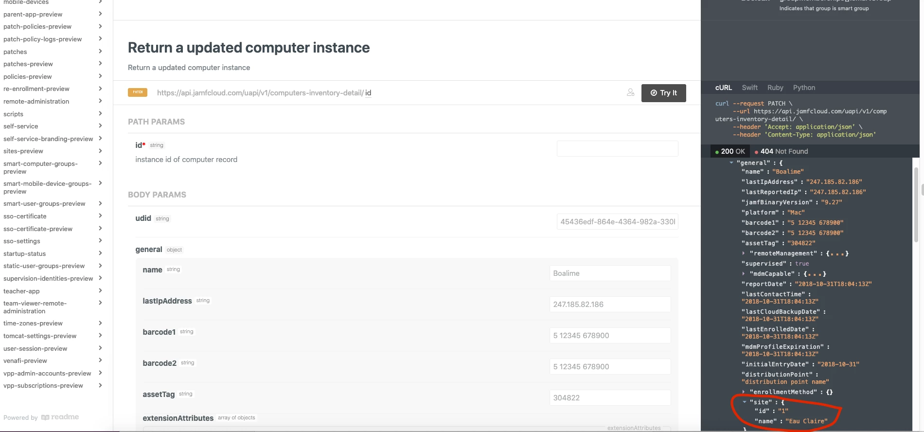

@Phantom5, thatnks for the info, it is a bit confusing though.... per: https://developer.jamf.com/jamf-pro/reference/computer-inventory-1#patch_v1-computers-inventory-detail-id
I can see that there is site (see attachment please), but when trying to add it in various ways I receive 405.
The path per what I see in the reference - "{\\"general\\":{\\"site\\":{\\"name\\":\\"EMEA - London\\"}}}" - looks correct to me, I have tried it with additional brackets, but getting the same error...:
curl -X PATCH "https://jss.MYCOMPANYcom:8443/uapi/v1/computers-inventory/$id" -H "accept: application/json" -H "Authorization: Bearer $token" -H "Content-Type: application/json" -d "{\\"general\\":{\\"site\\":{\\"name\\":\\"EMEA - London\\"}}}"
Am I not putting the right path after -d?

Nevermind, PATCHing site is simply not available yet 😞
"The PATCH endpoint does not currently support the ability to update the site of a device. The right column where you're referencing the site element is the expected response to a PATCH request, not the request itself. The center column defines allowable elements to the request body, which you'll see sites are not listed. I'd recommend filing a feature request, if one does not already exist."
