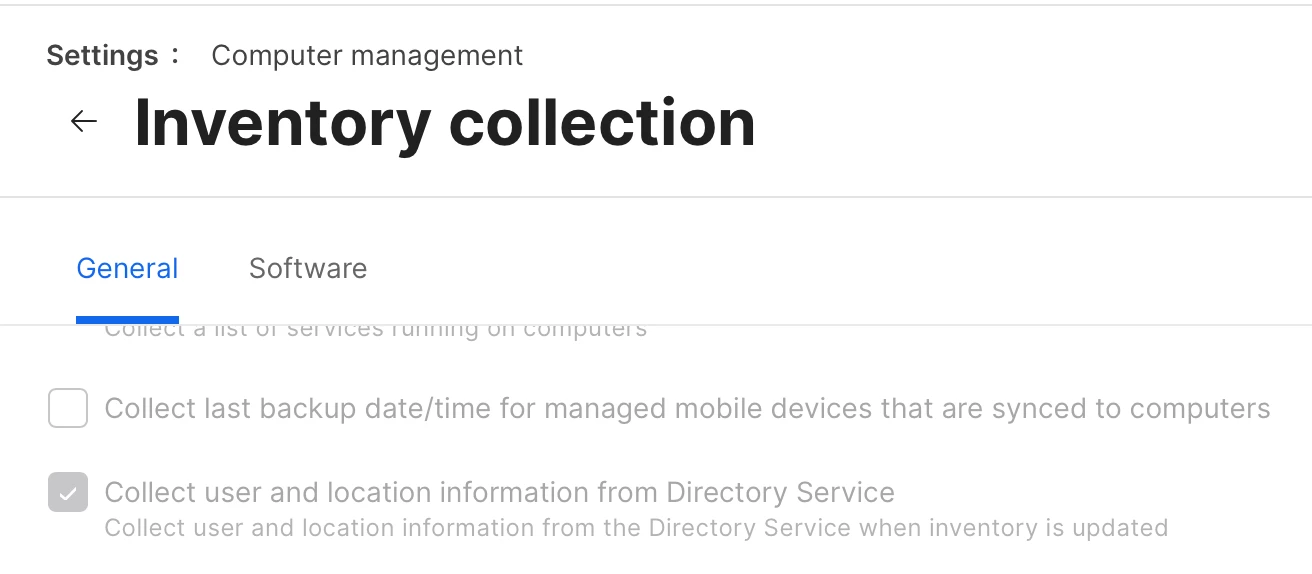

Shyamsundar
  • Oct 18, 2024 5:20 AM UTC
Settings -> Computer Management -> Inventory Collect , Enable Collect user and location information from Directory service,
if your user account name created on the Mac is the same as that of in Azure Ad, it will capture the information during the recon and update in JAMF
