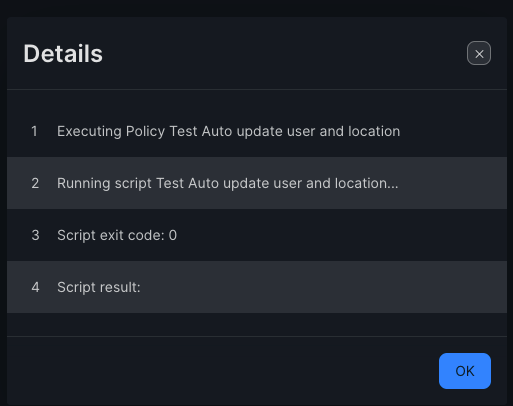

JamfAdmin2
  • Sep 20, 2024 2:35 PM UTC
yea, maybe try it first
It was completed but no changes happended
YanW
  • Sep 20, 2024 2:58 PM UTC
update inventory
Jason33
  • Sep 20, 2024 4:43 PM UTC
Arent those fields populated by LDAP mappings? Do you have an LDAP server integrated with your Jamf instance? If not, start there. You'll also want to go in to Settings - Computer Management - Inventory Collection and make sure to check 'Collect user and location information from Directory Service'. When a recon is completed, that info should update, if its not already.
And one more thing...check your PreStage and confirm in Account Settings that 'Pre-fill Primary Account Information' is checked. That might help out as well.
