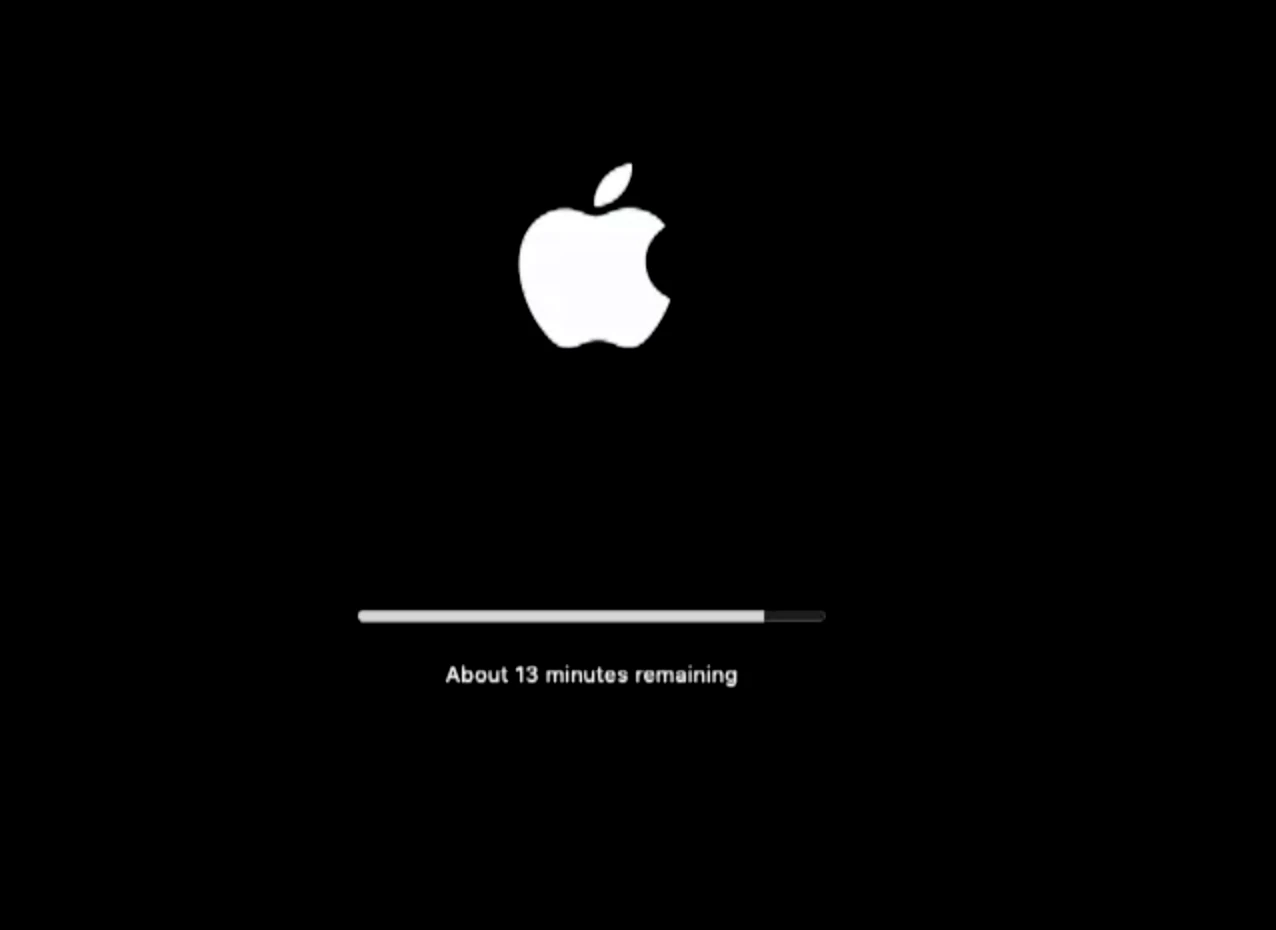

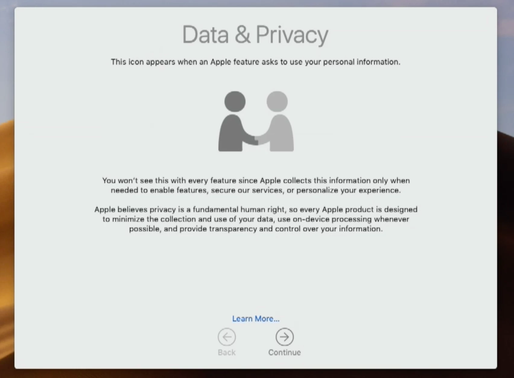

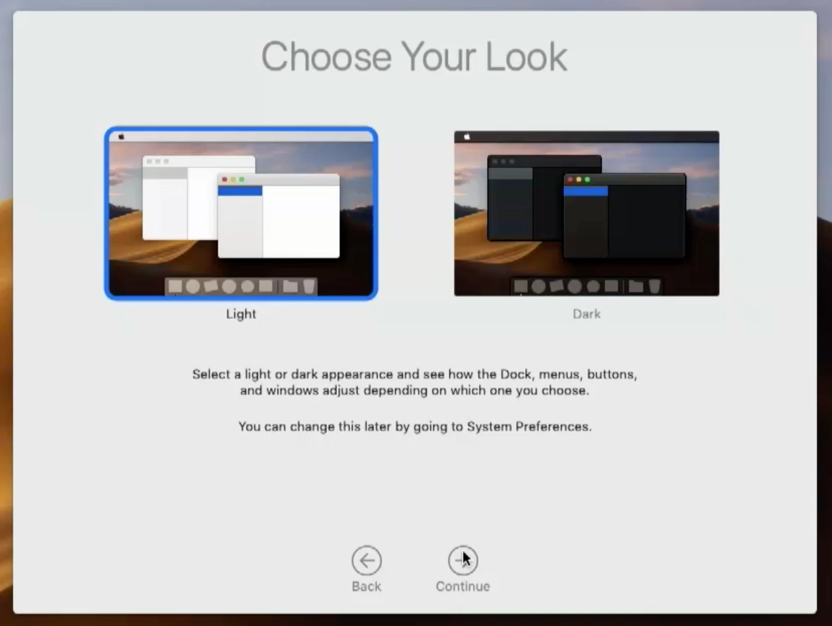

szultzie
  • Nov 15, 2018 7:45 PM UTC
I get the following screen after an update is complete and i log in for the first time
then
and finally this
The last two im sure I can get around somehow, but i don't like that it reboots the computer after first log in, after an in place upgrade, I cant automate that for a Lab environment.
-Peter
