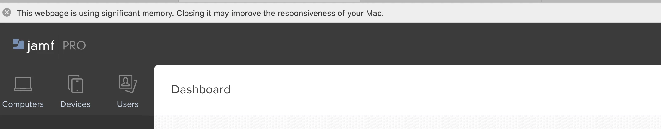

Does anyone else get this all the time in Jamf Pro console with Safari?
yes
@kericson Yes. I use Safari for most tasks and having that banner constantly coming and going while in the dashboard is annoying to say the least.
I too am getting that message now that we have upgraded to 10.21 last week. I just looked and Safari is using almost 2gb of RAM.
I just started getting this after upgrading to 10.22

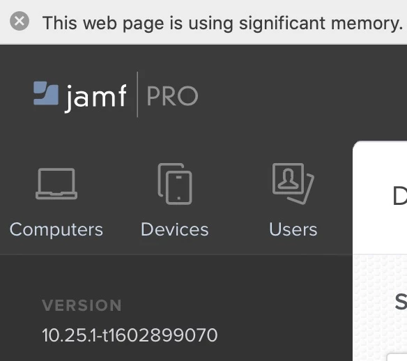

In our Jamf Pro cloud world this incident still exist with jamf version 10.25.1-t1602899070 and safari Version 14.0 (15610.1.28.1.9, 15610)
Hey @dsardaczuk! I am bummed to hear you’re still experiencing this issue. With the release of Jamf Pro 10.25.0 the engineering team has resolved all root causes for these type of struggles that we were able to identify. If you’re still seeing issues it sounds like there might be another root cause to dig into. Please be sure the cache has been completely cleared recently and then if you continue to see it I’d recommend filing a Support ticket. I would prefer to have you in direct contact with fast communication channels. I love Jamf Nation but unfortunately my response times vary a lot! I don’t want to drop any balls with regards to getting you the help you need and determining the new issues as fast as possible.
To help Support start digging in please be sure to tell them that you’ve upgraded and cleared your cache. I’d also recommend helping them focus the triage by sharing what Jamf Pro pages you have spent the most time on when you experienced the error. This won’t necessarily be the page you see it on. It could be a page you have spent a significant amount of time on and then moved somewhere else. It’s likely an area is causing the memory issue to build up, but it manifests after you navigate elsewhere.
Once again, thank you for helping us dig in and make the product better.

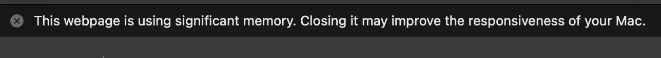

Here it is again.
see image
This is still happening. I'm getting really sick of seeing this while working in Jamf Pro. I WILL NOT switch to a different browser. My MacBook Pro has 32GB of RAM and my iMac has 24GB. I have more than enough installed memory for Safari to use a lot if needed. Every other site that I use when I am working does not do this. It's only happening with Jamf Pro.
