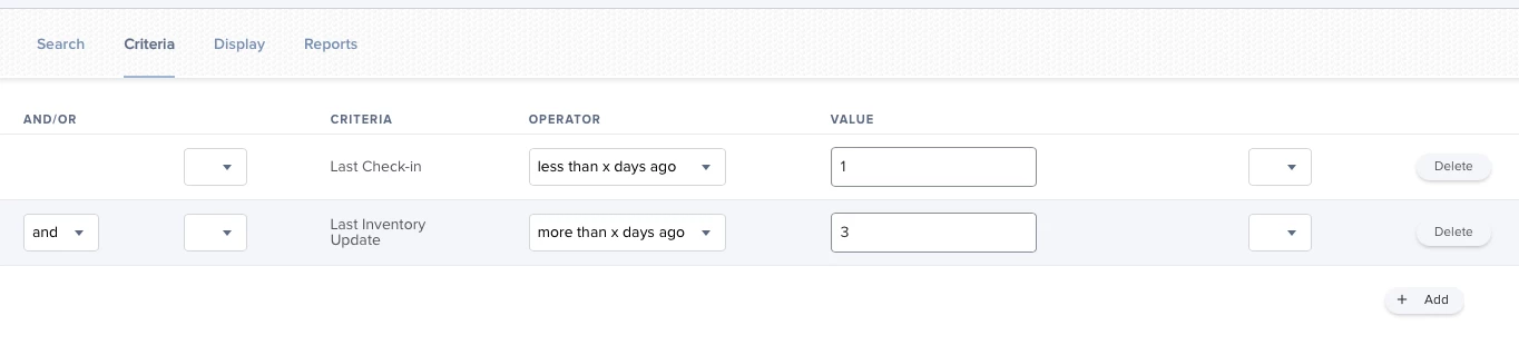

No problem, we recon at least once a day, so this works well for lab computers that are 'supposed' to be on 24/7.  Just create a smart group that sends an email notification on membership change.  Also fwiw, after submitting a support ticket, Jamf performed maintenance on our Jamf Cloud DB which resolved the issue.
