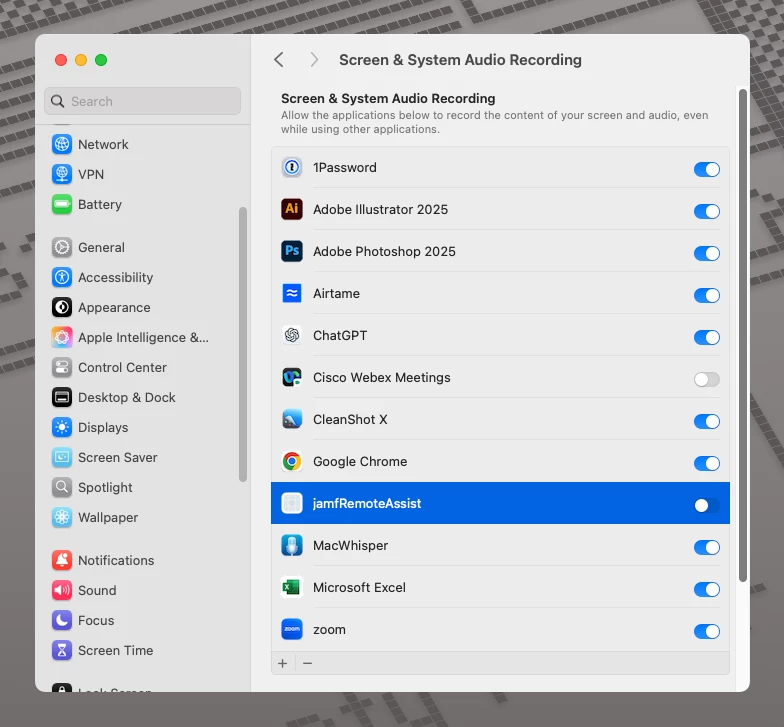

red_beard
  • Jul 7, 2025 2:50 PM UTC
I’ve found I can now only get it to work when I have a user enable this toggle, which isn’t great depending on the problem they are having in the first place! But it usually works after they enabled this in our environment. There doesn’t seem to be a way to create a policy to enable this out of the gate for them via PPC or something like that, that I’m aware of.

vshulhin
  • Jul 8, 2025 5:46 AM UTC
As I understand it, this toggle needs to stay enabled permanently for Remote Assist to work properly, right?
red_beard
  • Jul 8, 2025 12:06 PM UTC
Yes, this toggle needs to stay enabled in my experience.
