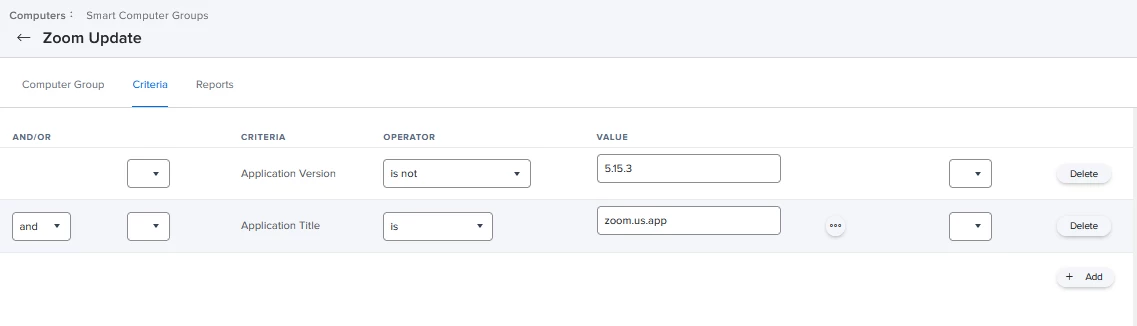

Hello team,
I was wondering if you can assist me on a quick and easy matter. I'm trying to create a Smartgroup to update all of our machines to the latest Zoom update. I just want to know if there's anything else that I'm missing for criteria. See screenshot.
One more thing, once the smartgroup is created and the patch take effect, do the machines get excluded out of the smartgroup once the patch is complete with the new update? I just want to make sure because Jamf support said it does.

looks fine.. BUT.. if your cloud based.. then consider using JAMF Mac Apps.. is way simpler.. just create a smart group 'has app Zoom' and use that group as target group.
Obvs test with a pilot group before deploying to estate.
Note that JAMF deploys Zoom IT version.. not Zoom consumer..

If you are using Mac Apps or Patch Management there is no need to also use a Policy to update Zoom. Patch Management is literally just a policy that JAMF keeps up on the smart groups.
  • Install with a Policy, Update with Patch Management.
  • Mac Apps can kinda do both.
I'm still Old School and like to use policy to update instead of Patch Management.
As far as your Smart Group Criteria, it should work. I usually target less then for the Application Version rather then is, that way if a device gets a newer version of the Application JAMF wont try to reinstall the older version. Unless you want to keep up with what zoom is doing to update your Smart Group as new releases come up.

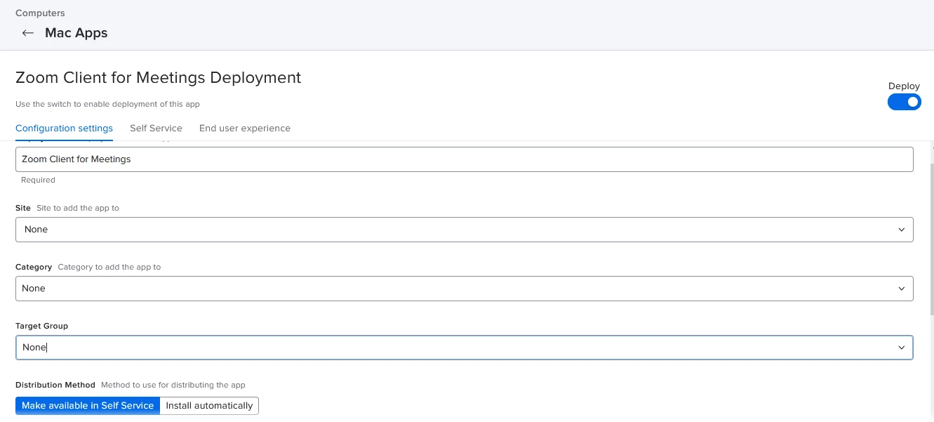

Hey guys, so I'm in Mac apps, I select: Jamf app Catalog, and searched Zoom client. In here (See Screenshot) when I select the "Target Group" dropdown, it brings up my smart group for Zoom which has all of my company's macs.
Is there a way to add a Static Group as part of the test? Or do I need to lower the version in my criteria in my Smart group in order have a batch of test machines only. Thanks.

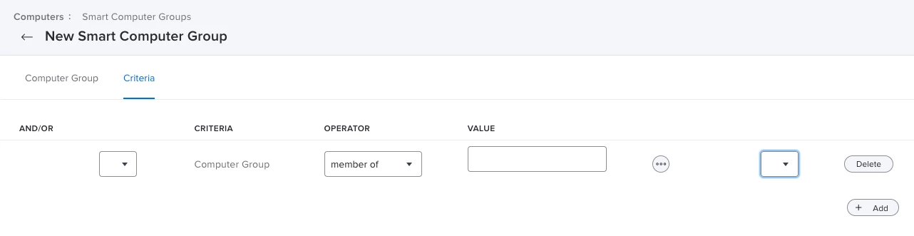

@rdeleon you can create a Smart Group that has the criteria of 'member of' a Static Group. You then use that Smart Group in App Installers.

@JustinC Hey Justin, I just did what you mentioned I was able to find four machines including two testers that I have. So last night, I created a "Zoom update test" smart group for this test, selected the Zoom app in the Jamf catalog, selected the group and the machines are "In progress" status. I checked just now and the machines are still in "In progress" status. The two testers are on and the Zoom app is closed on both of them. I was wondering how long does the deployment take? Thanks .
