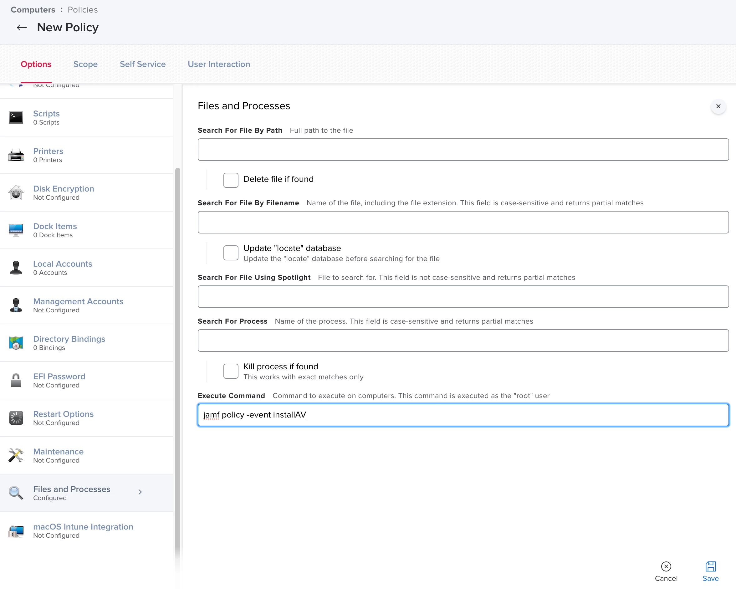

I'm not sure if there's a reason this wouldn't work with your AV products, but to me, it sounds like the approach I would take would be making a policy to remove the old AV, and include a files and processes payload using the Execute Command section to call the install of the new AV product by custom trigger (like the image below). As long as you have the new AV with that custom trigger, it should run that after the initial uninstall and without the use of receipts or additional smart groups.
Now if there's a reason this won't work, I would use the same execute command to touch a hidden file or something that an Extension Attribute could then check for.
I didnt even think custom events.... this might work!
Edit.... maybe not... there is configuration profiles on top of the that go along with the policy package
